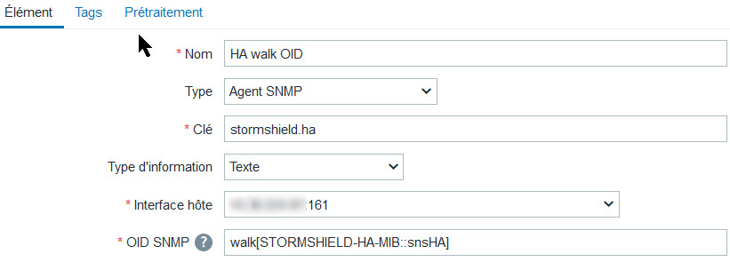

    1) I created the item:
    It works fine and I get a result like this:

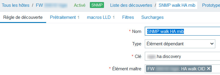

    2) Then I created my discovery rule:
    Test works fine and I get:
    [{"{#SNMPINDEX}":"0","{#SN.SERIAL}":"XXX","{#SN. ONL INE}":"1","{#SN.VERSION}":"ABC","{#SN.LICENCE}":"M aster","{#SN.HEALTH}":"Major"},{"{#SNMPINDEX}":"1" ,"{#SN.SERIAL}":"YYY","{#SN.ONLINE}":"2","{#SN. VER SION}":"","{#SN.LICENCE}":"Unknown"}]

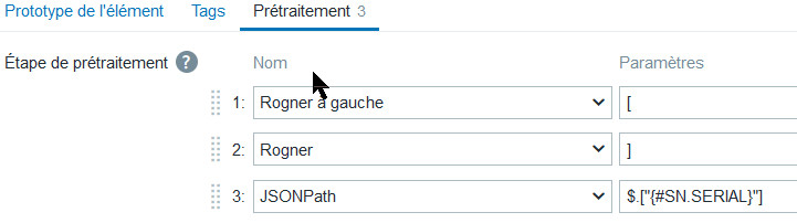

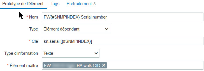

    3) Then I finaly create a dependent item prototype:
    preprocessing: Tried different thing readed on the web. This last works in test mode with JSON in values.
    My problem is that it doesn't work in real life, It seems my item prototype is using with what the early item returns (could be logical 'cause it's the master item...).

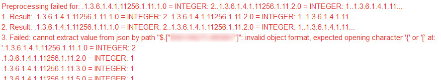

      Sorry, I forgot to post the error:
      Without preprocessing in item prototype, it returns the whole early item without error.

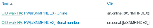

            Without preprocessing, the prototype creates an item that returns the all master item result. That's also the reason I have items where I can see that {#SNMPINDEX} is working for item name and item key:
            (This means that the macro I want as a value could be writen in the item name withaout any problem. Crazy isn't it?)
            With any preprocessing, the error is:
            Preprocessing failed for: .1.3.6.1.4.1.12345.1.11.1.0 = INTEGER: 2..1.3.6.1.4.1.11256.1.11.2.0 = INTEGER: 1..1.3.6.1.4.1.11...
            1. Failed: cannot extract value from json by path "$[?(@["SNMPINDEX"] == "1")].1.3.6.1.4.1.11256.1.11.7.1.2.0": invalid object format, expected opening character '{' or '[' at: '.1.3.6.1.4.1.11256.1.11.1.0 = INTEGER: 2
            .1.3.6.1.4.1.11256.1.11.3.0 = INTEGER: 1
            .1.3.6.1.4.1.11256.1.11.5.0 = INTEGER: 1
            This lets me think that prototype works with the master item result and not the discovery result.
            This goes back to "Ensure the prototype is linked to the discovery rule"....
            Thanks for helping
