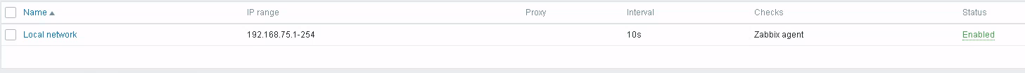

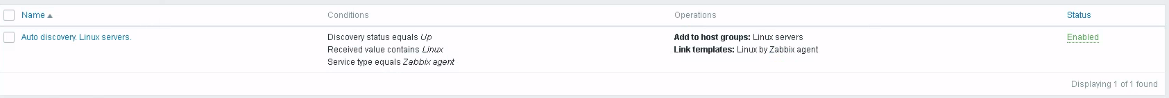

          I am not too familiar with the terminology yet but I am uploading pictures of what I have configured. I suspect that I need an action or a rule that says to auto add the linux machines to inventory for monitoring.
          Those are the default rules that I tweaked slightly and I have enabled. Am I just missing a rule or an action that says auto add?
          Also your last link doesn't have any data.
            10s for a discovery rule to run.. too often... it is probably still busy with previous run...
            "add to hostgroups" already takes care of adding a host.. there would be nothing to add, if host is not created...
            I have always found all that network discovery to be awkward, if we already have autoregistration options... Why bother to search for those agents, if they can come by themselves, say hello and get their initial monitoring instructions? If you would need to discover some dumb printers or something, but agents... bleh.. Better add autoregistration action, than discovery...

              I initially had this at 1hr and nothing happened. Switched it to 10 minutes and nothing happened. I am currently on a test system right now but even if I stuck this in a non lab environment, there wouldn't be anything like printers etc..
              So I am confused at this moment. Right now, what do I need to do to add hosts automatically? Am I missing a step?

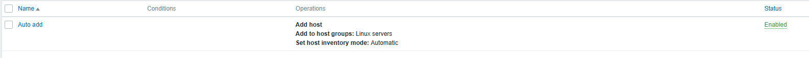

                    Been trying to wrap my brain around this (slow learner, bare with me). I created one but I noticed the condition has hostname options and I left that blank. I am thinking that it will just dynamically populate the hostname but I guess I am wrong.
                    I also added some operations, nothing has populated just yet. Click image for larger version

                      You created a autoregistration action, right?
                      In Zabbix 7:
                      Alerts -> Actions -> Autoregistration actions
                      In Zabbix 6:
                      Configuration -> Actions -> Autoregistration actions
                      If you did it, then yes, it is configured correctly, you don't need any conditions for it to work...
