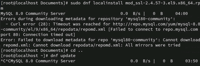

    I have problem to run any zum, dnf command on my appliance
    Runnig on centos9
    Every yum, dnf is stucked on Mysql community Server, for example:
    Any idea how to solve it?
    I need install ssl/tls package to redirect http to https becasue I need public it to the internet trought port 443
    Thank you

    Have tried pinging the repository to validate if the connection is ok?
    • tibortanyasi
      • Jan 2025
      I tried local installation from local folder of centos... doesnt work
      I tried alsi installation from repo, also not working
      also any command like yum update, yun install whatever... doesn not working working
      Im able ping any internet site, for exmple 8.8.8.8, etc, so internet is working
      It seem like something wrong with OS, or?

        Try:
        curl -I http://repo.mysql.com/
        or even
        curl -I http://repo.mysql.com/yum/mysql-8.0-community/el/9/x86_64/repodata/repomd.xml
        you should get something like:
        If your response will be different than most probably there is some sort of an issue with your network configuration
