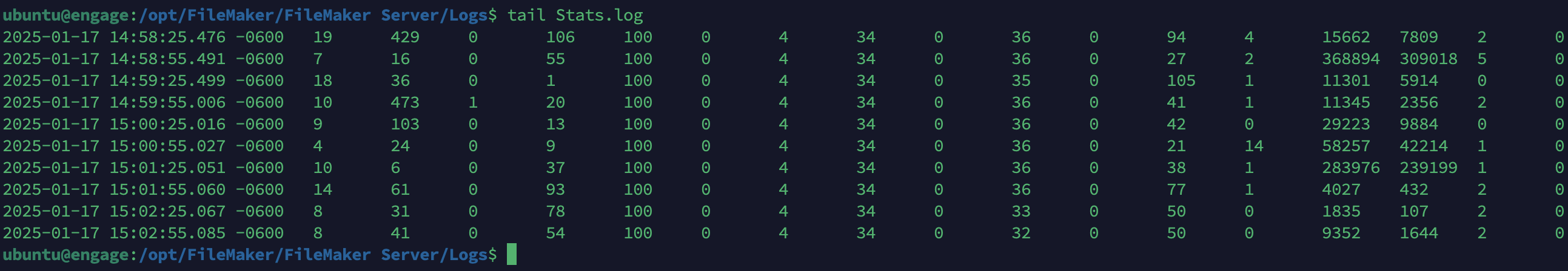

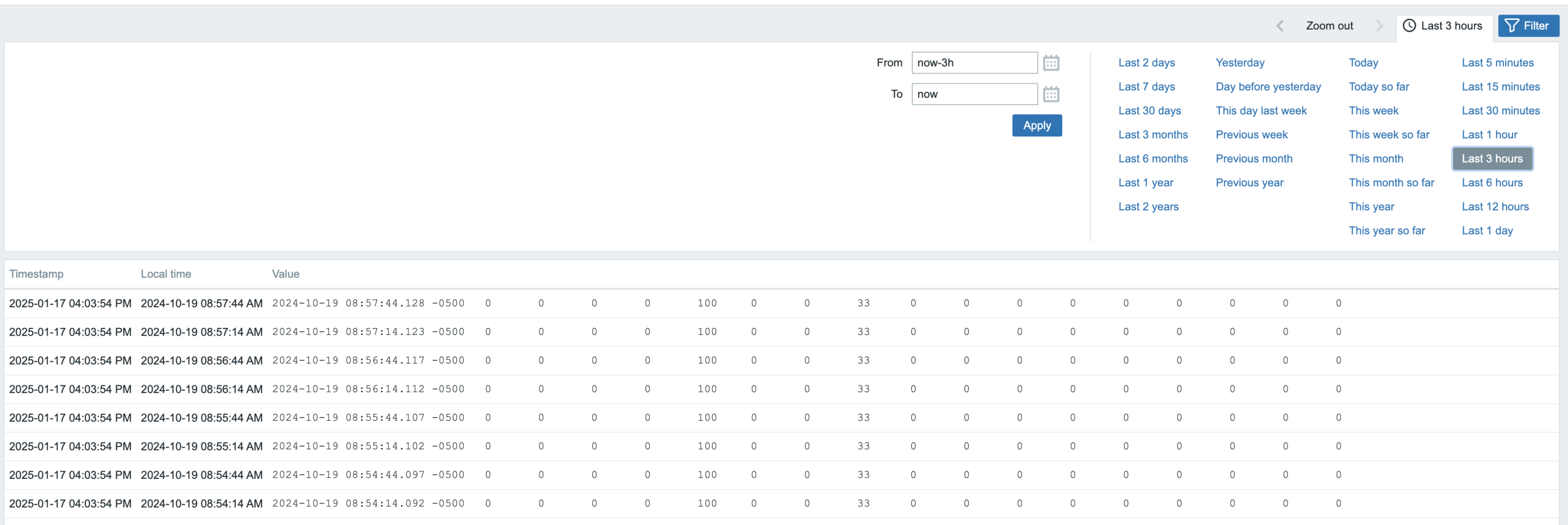

    I'm trying to view a log in Zabbix and it won't give me current data, regardless of my date filter. Even asking for the 500 most recent still gives me values from 3 months ago. How do I fix this? Click image for larger version

      These 2 servers show current time for their respective time zones. they are only 1 hour apart. Not 90 days.

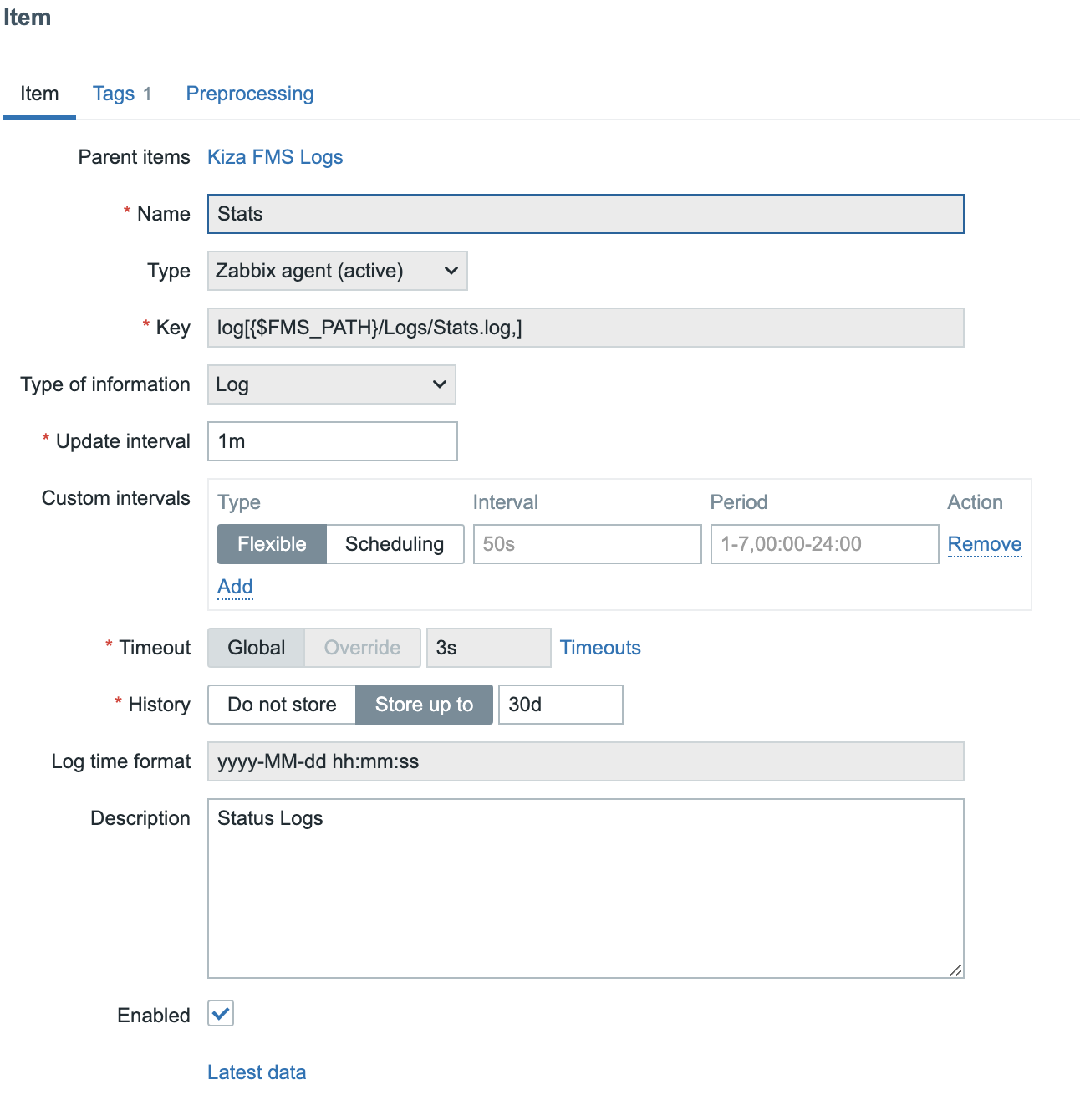

      As for the item config, not entire certain what you mean but it's configured as per the screen shot. It's the same config I use on all of my servers. They are reporting the stats fine. That's why I am so confused. Click image for larger version

        log and not logrt? Not rotating logs? Still reading that old logfile from long time ago in some reason..?

          I ended up resolving it by forcing a log roll over. I just reduced the size the log from 40M to 10M. This created new logs and Zabbix is now reading the correct dates.
