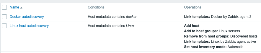

              So Donkey .. edit your zabbix_agent2.conf and configure
              HostMetadataItem=system.run[/etc/zabbix/hostmedatascript.sh]
              which I now learned runs the script /etc/zabbix/hostmetadata.sh
              This script in turn is a very simple one that does a uname to get the operating system type and apt list --installed to list all packages, with some formatting added to make this a one-liner (not sure if it's needed) and strip out some packages we don't care about in any case.
              #/bin/sh
              uname | cat | tr '\n' ' ' && apt list --installed 2>/dev/null | grep -v -E 'lib|Listing' | cut -d'/' -f1 | tr '\n' ' '
              The script is run quite often by default and if the package listing is a heavy task for the system you can turn up the value
              RefreshActiveChecks=5
              so it doesn't run too often.
              Here are the Autoregistration rules that picks up the base operating system and the docker package.
