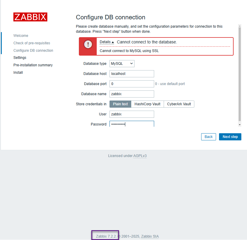

    Fresh Zabbix 7.2.2 : MySQL - Cannot Connect to the Database
    I followed the procedure step by step. My Infra: rhel 9.4 server / mysql
    When I use my browser with the url : https://myserver.mydomain.com/zabbix , I'm getting next screen:
    My SSL certificate is working ok, and I'm able to open a session on mysql ( mysql -uroot -p ) and use zabbix database.
    My firewall and selinux are disabled.
    Could you give somes clues.
    Thank you.​

    Try running:
    systemctl restart zabbix-server
    or
    systemctl status zabbix-server
    If the server status is other than running than it might be caused by some errors with the DB. Maybe importing the schema didnt work? If so run
    zcat /usr/share/zabbix/sql-scripts/mysql/server.sql.gz | mysql --default-character-set=utf8mb4 -uzabbix -p zabbix
    Restart the server and try web api again.
    • carlos.pena
      carlos.pena commented
      Thanks Blevar, but that didn't work.
    Are you able to use that database with user zabbix? (mysql -uzabbix -p) ?
    • carlos.pena
      Yes, I'm.

    • tim.mooney
      • Dec 2012
      • 1436
      For carlos.pena : is the "using SSL" part of the original error message a potential clue? It has been a very long time since I did a fresh install of the Zabbix front-end (web interface), so I'm not certain about how or if it presents an option to disable encryption for the database connection, but when you're using MySQL/MariaDB/Percona on the same host and you're connecting through the UNIX socket, you don't need (and I think don't want) encryption for that connection. It's not going over the network at all so there's no danger of eavesdropping. If your database server were on a different host, then a network-based connection would be required and using TLS encryption and proper certs would be highly advisable. It's only when both database & app are on the same server and they're configured to use the local socket that encryption isn't needed.
      For the front end (web interface), you obviously need to have all the correct PHP extensions loaded. The previous screen should have verified that you have them all I think. Was everything good on that screen?
      If you run
      php -i
      (can be run as a normal user) and look at the mysqli and mysqlnd section of the output, is the value for mysqli.default_socket the correct location that MySQL server is using to create the socket file? There have been a few reports on these forums in the past of PHP's extension not using the correct / updated location for where MySQL server is configured to actually create the UNIX socket. That seems like it was a misconfiguration only for certain distros packages, though, and I don't think that affects RHEL (I'm using RHEL 9.x as my server too, but I'm not on 7.x yet). Probably worth checking though.
      • carlos.pena
        Yes, everything is good on checking screen, and the location for the socket is Ok too. Thanks Tim.
