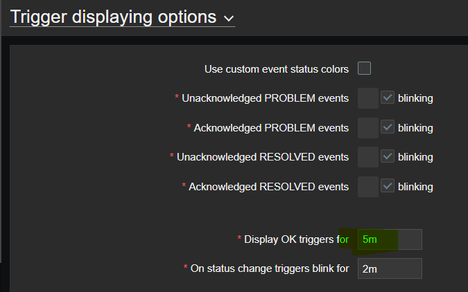

    • 5002
    and I think v7 has already "update" link in problem line in problem list? From there you can "ack" it if needed. In older ones you needed to selectthe problem and go to "mass update"...
