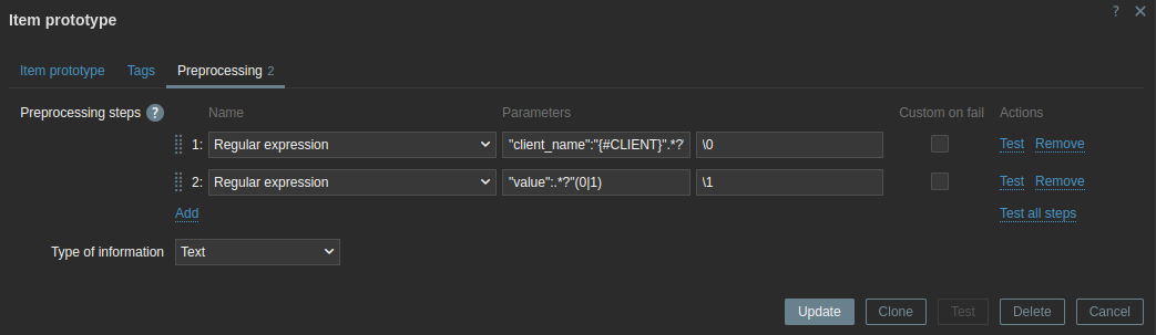

            Since that's what you need, i think you can do the following:
            1. Create a discovery rule that is dependent to your HTTP item.
            1.1. In the discovery rule, create a LLD Macro to store your client_name, let's say {#CLIENT}
            2. Create a item prototype in this discovery rule that is dependent to your HTTP Item.
            2.1. Set the name of the item to something like: Value on {#CLIENT}
            2.2. Set the key of the item to something like: value[{#CLIENT}]
            2.3. Set the value type to "Text"
            3. In the preprocessing tab of the item prototype, do the following:
            3.1. Add 2 regular expression preprocessing steps, like:
            3.1.1. Parameter "client_name":"{#CLIENT}".*?"value":.*?\]\} with output \0
            3.1.2. Parameter "value":.*?"(0|1)with output \1
            Be aware that i didn't test the whole thing. I did test the regex, with {#CLIENT} being default and test, so you will need to store those values exactly like that in your LLD Macro, or you could also change the regex...
            I based this in a template that i created in my structure, the ideas are the same but it may need some adjusts.

              Hi kyus,
              Thank you very much for your explanation. I've updated my discovery rule and item prototype, when I press the test button it works - BUT when I apply the template to a host I only see the main item in Latest Data.
              Is there a way I can debug the discovery rule?
              • kyus
                • Feb 2024
                • 203
                Maybe your macros aren't being extracted as expected.
                In the way I made it, the macros need to receive a the value without any extra characters, in the example it would be only default and test
                Sometimes it can be a little bit tricky to extract these values with JSONPath and not have any extra character like a bracket or a quotation mark.
                You can try using different paths to get the right value

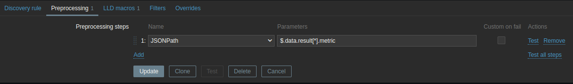

                • daniva
                  • Jan 2025
                  Hi kyus,
                  Would appreciate it very much if you could give me a hint how to define the preprocessing and LLD for the discovery rule - unfortunately I'm getting nowhere with it....
                  • kyus
                    • Feb 2024
                    • 203
                    Hey, try doing the following:
                    In your discovery rule add a JSONPath preprocessing step with path: $.data.result[*].metric
                    In LLD macros add a {#CLIENT} macro with path $.client_name
                    Then proceed to create the item prototypes as described in the previous post.
                    Test it out and see if it does what you expect!​
                    • daniva
                      • Jan 2025
                      Hi kyus,
                      You're a hero! - it works. Could you maybe help me with a trigger prototype as well? Value 0 should create a warning.
                      Thank you very much.
