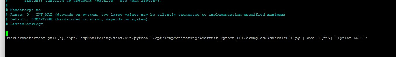

    in the zabbix_agentd.conf I added the following
    AllowKey=system.run[*]
    UserParameter=dht.pull[*],/opt/TempMonitoring/venv/bin/python3 /opt/TempMonitoring/Adafruit_Python_DHT/examples/AdafruitDHT.py | awk -F[=*%] '{print $$$1}

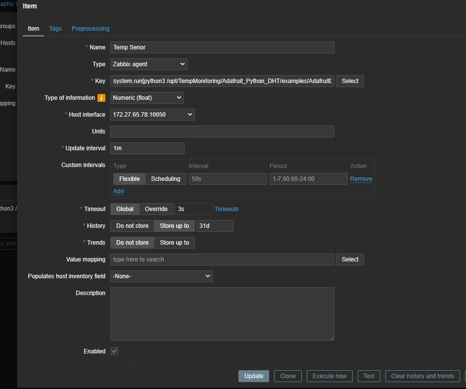

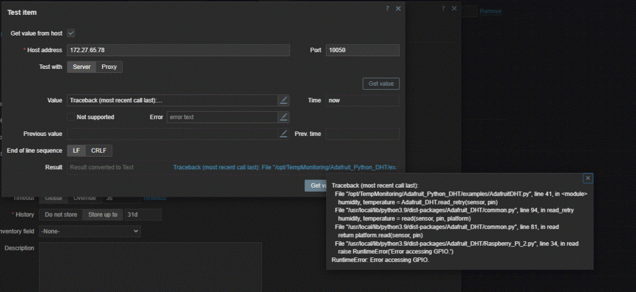

    In the Zabbix Server for the host I created a new Item with the key system.run[python3 /opt/TempMonitoring/Adafruit_Python_DHT/examples/AdafruitDHT.py 11 4] but when I test/run the Item python errors that it's looking for library files from /usr/local/lib/python3.9/dist-packages/Adafruit_DHT/

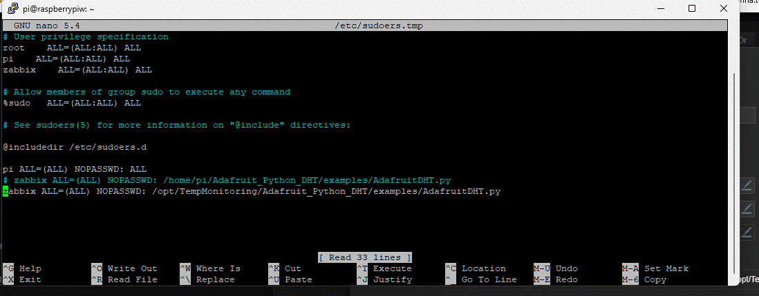

    I added ( at least I thought it is correct) the zabbix user with privileged access as well as the includedir variable

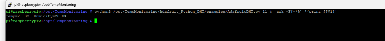

    I can run the the script from CLI python3 /opt/TempMonitoring/Adafruit_Python_DHT/examples/AdafruitDHT.py 11 4| awk -F[=*%] '{print $$$1}' without issue and without the sudo command

    You are using user "pi" to test and run the command... but your zabbix agent does not run as user "pi". It is running as user "zabbix". So you should be testing under that user. Your environments are probably not same for those users. You can miss paths etc...
    With sudo rules you shoudl add full command there.. not just path to script. And then also your Userparameter should contain "sudo"...
