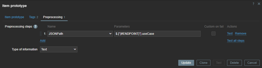

    Item Prototype (I've tried variations on the JSON path here)
    Name: {#ENDPOINT}: TLS Version
    Type: Dependent Item
    key: azcmagent.check.connectivity.tlsversion[{#ENDPOINT}]
    Type of Info: Text
    Master Item: [Template] Azure Arc Check (JSON/Master)
    Processing: JSONPath -> $.[{#ENDPOINT}].tls
    Click image for larger version  Name:	image.png Views:	0 Size:	18.4 KB ID:	498348

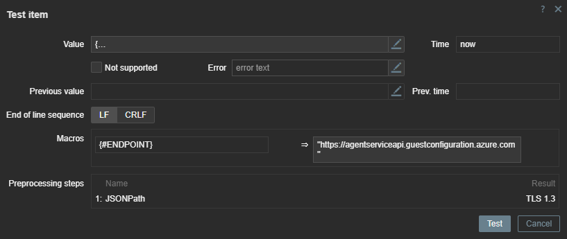

    If I manually set the macro value in the prototype to "https://agentserviceapi.guestconfiguration.azure.com" for example, I get the correct value of "TLS 1.3". However, if I just leave the item prototype as is, it doesn't process anything. Which makes me think something is wrong with the LLD macro
    Click image for larger version  Name:	image.png Views:	4 Size:	20.5 KB ID:	498344​

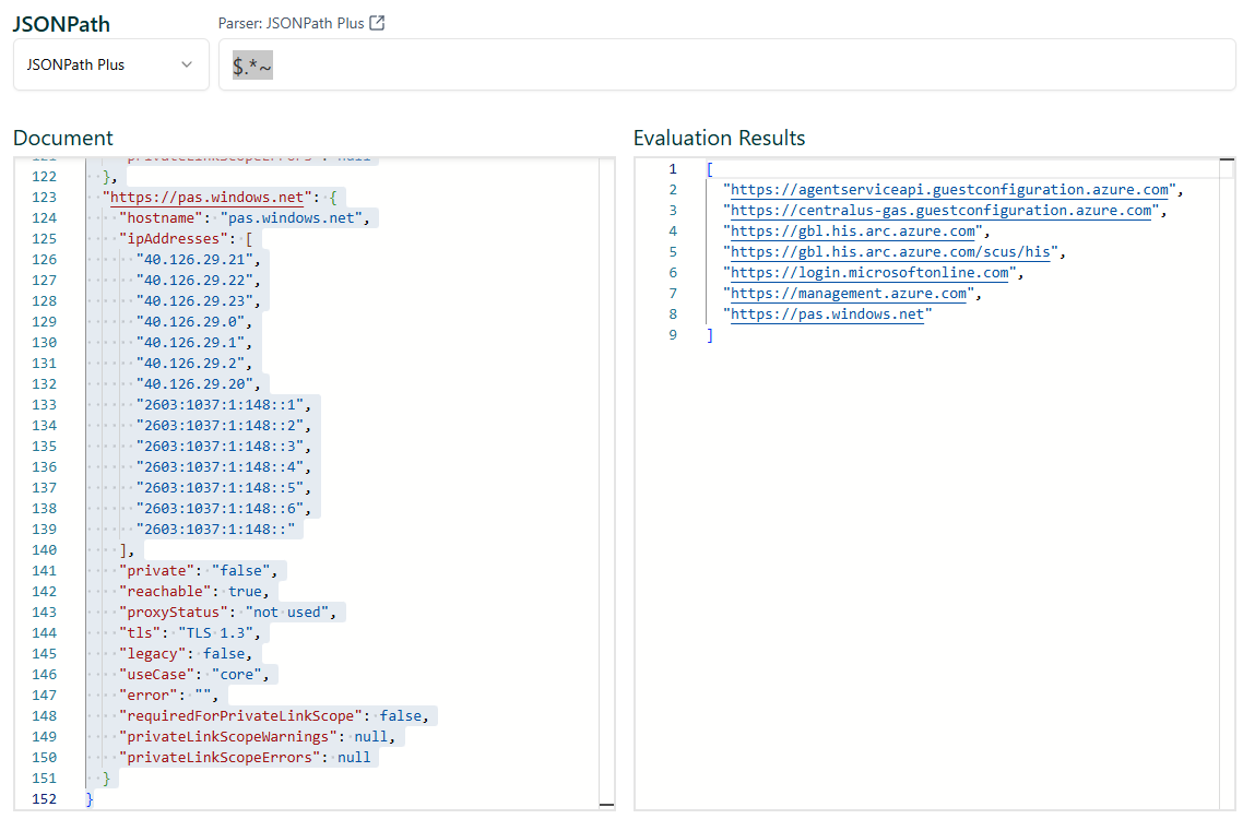

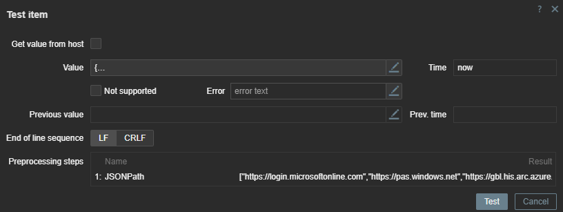

        To answer my own last question: This is testing the $.*~ JSON path, which appears to be correct. Doesn't appear to be generating any items though.

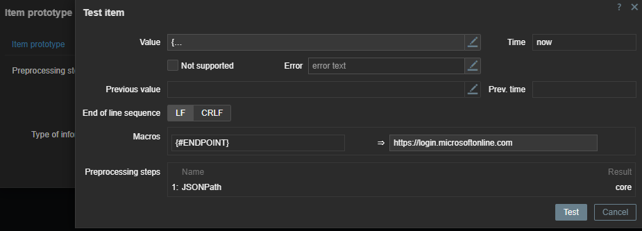

        Item Prototype (with a member of the array?) - parses correctly. I did double check the item and rules. The discovery rule is enabled, as is the create and discover in the item prototype. Now I'm actually confused. All the pieces seem to be in place.
