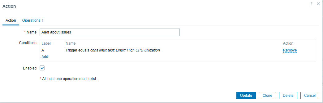

            So i created this alert and I didn't create anything else additional, the operation just adds the email portion. I configured it for a specific purpose to trigger just for high cpu utilization.
            If I add more than 1 trigger, will that affect the process I am trying to setup or do I need multiple actions with different triggers to do what I am looking for?

              I usually use tags to filter wich alerts are going to be sent. You can also use trigger severity + host group, for example.
              You should create the combination that suits your environment requirements.
              If you have a bunch of alerts that you want to be notified of, i would suggest using tags on your triggers.
              For example, you could create a trigger called "alert" with value "email" in each trigger (in template level).
              For the low/high priority, you could also use tags or host groups to separate it.
              It'll work, just make sure to use the OR operator, but this would be harder to maintain, since you'll have to add each trigger to the condition.

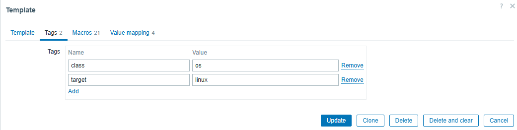

                Sorry, a bit confused by your post. I looked at tags in the template and there isn't much going on there.

                  You can add your own tags, but for alerts, I would recommend adding them to your triggers / trigger prototypes.
