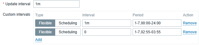

    We've got a batch of about ~300 monitored computers that reset themselves between 3:05 to 3:35 AM semi-randomly, within 5 minutes intervals (some at 3:05, some others at 3:10... to 3:35). The uptime for those computers is monitored by a cloned Windows by Zabbix Agent template, with the default custom interval of 1 minute for 1-7,00:00-24:00. To avoid being warned by these resets we added an exception (interval of 0 for 1-7,02:55-03:55), because they meant more than 600 e-mails for each one of us. And this was working fine until we updated one of the last minors on Zabbix Server 7 LTS (can't remember if that was 7.0.8 or 7.0.9).

    Without having changed the custom interval during months, we recently noticed that we're being e-mailed with the reset warning again (uptime < 10m). Trying to debug the problem, we noticed that we're receiving data during the time where the interval 0 shall be applied and the interval 0 is applied between 03:55 and 04:55, shifted one hour forward.

    It looks like your user profile time 1 hour offset to the zabbix server time?
    The time set in the custom intervals is zabbix server time.

      These computers are monitored by two proxies. The proxies, that also synchronize with the same NTP server, were set to UTC instead of CET/CEST. I'm trying to analyze why did the proxies shifted the timezone without explicitly having done it.

        Question... Why you have 2 flex intervals? Shouldn't the one with 0 interval be enough? Why redefine the regular interval of 1m for 24/7?

          Well, that's a good point and you're right. I left it like that because within the original template, that item (and all the others) came with a defined custom interval defined on an equivalent basis. So when I updated the uptime check from 30s to 1m, I also updated the custom interval from 50s to 1m.
          Now that makes me wonder if that doubles the amount of data collected from every host.
