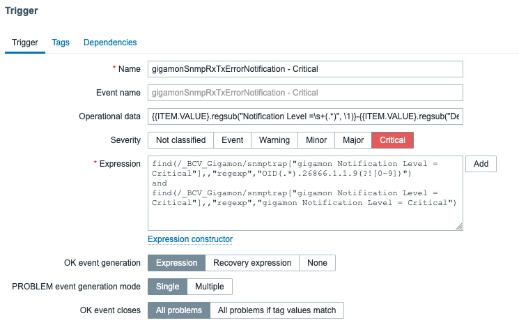

    Hello. Trying to get an understanding of the use of the find() function in trigger expressions. Have a scenario where only need to fire a notification to third-party ticketing only if the SNMP trap has severity of "critical"; lesser severity would not and just be ignored. After the event is pre-processed and logged, nothing happens even though the regexp parameters are met. When I look through the documentation does not appear multiple find() functions can't be done. Not sure if I am misinterpreting the scope of find().
    Zabbix 7.2.2

Name:	Screenshot 2025-02-06 at 1.08.31 PM.png

    Why multiple finds?
    find(/_BCV_Gigamon/snmptrap["gigamonSnmpRxTxErrorNotification - Critical"],,"regexp","\.26866\.1\.1\.9\s.*\s.*Notification Level = Critical\s")
    Online regex tester and debugger with real-time match highlighting, detailed explanations, substitutions, unit tests, benchmarking, and code generation. Supports PCRE2, JavaScript, Python, Go, Java, .NET, Rust, POSIX ERE, and POSIX BRE.
