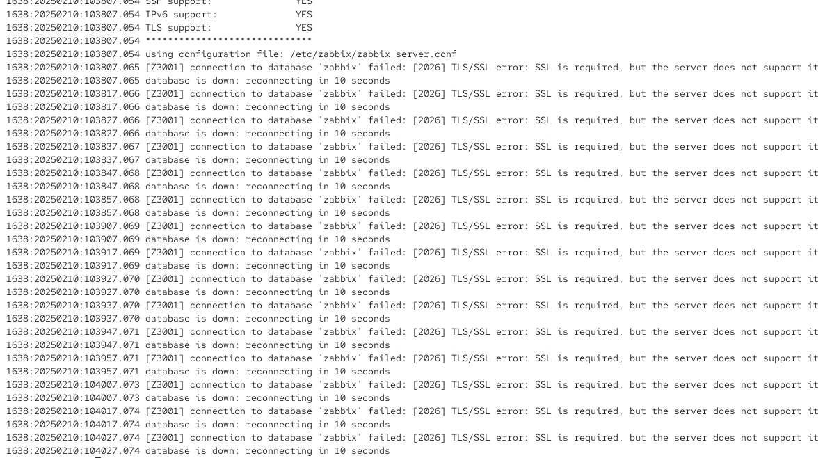

    Hey guys,
    I have tried twice to install and get this working but I cant get past the following;
    [Z3001] connection to database 'zabbix' failed: [2026] TLS/SSL error: SSL is required, but the server does not support it
    database is down: reconnecting in 10 seconds
    This was on the back of seeing Zabbix server is running 'no' under system information.

    Hey Donkey,
    Its in the /var/log/zabbix/zabbix_server.log log
    Uploaded a screenshot of it too.

      What DB are you using? Postgres? MySQL? Maria?
      in /etc/zabbix/zabbix_server.conf, are any of these values set, and if so, to what?
      DBTLSConnect=
      DBTLSCAFile=
      DBTLSCipher=
      Similarly, in /etc/zabbix/web/zabbix.conf.php
      $DB['ENCRYPTION']               =
      $DB['KEY_FILE']                 =
      $DB['CERT_FILE']                =
      $DB['CA_FILE']                  =
      $DB['VERIFY_HOST']              =
      $DB['CIPHER_LIST']              = ​
      Your database is telling Zabbix it doesn't support encryption, but you've configured (supposedly) Zabbix to use and enforce encryption. The two remedies are: enable TLS security on the DB or remove Zabbix's DB encyrption config.

        Hi MRedbourne,
        NEWBIE here so its very much basic setup as per zabbix setup doco.
        Zabbix is on CENTOS 10 with Maria and MySQL.
        DBTLSConnect=
        DBTLSCAFile=
        DBTLSCipher=
        $DB['ENCRYPTION'] = false;
        $DB['KEY_FILE'] = ' ';
        $DB['CERT_FILE'] = ' ';
        $DB['CA_FILE'] = ' ';
        $DB['VERIFY_HOST'] = false;
        $DB['CIPHER_LIST'] = ' ';
        any help/suggestions greatly appreciated.
        • jayhsu
          • Feb 2025
          I encountered the same error message as you. After removing MariaDB and using MySQL instead, I was able to execute it normally
