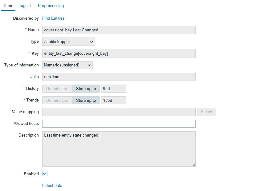

        FWIW here is how the item's value is created in an external check script (the item is a zabbix trapper):
        if ($state eq "unavailable")
            zabbix_sender::zabbix_sender($zabCustom::ServerDNS , $hostName, "entity_last_change[" . $entity_id . "]", 0 ); # use time = zero if unavailable
          else
            if(defined $last_changed)
                my $unixTime = int(str2time($last_changed));
                zabbix_sender::zabbix_sender($zabCustom::ServerDNS , $hostName, "entity_last_change[" . $entity_id . "]", $unixTime );

          You don't have any value mapping in the item config, so Zabbix isn't receiving the value you expect...
          The weird thing is, it is set to numeric unsigned, so you shouldn't be able to receive string values on this item...

            As a followup -- I removed the "unixtime" units, nothing else, and now the trigger works. Something about the "unixtime" is causing this translation before the comparison can be done. I'll just leave the units off I guess, but this to me seems a bit broken.

              I did some testing, the "Never" value that you're getting is because of the way the unixtime unit is processed, but the value is still zero.
              I was able to get this trigger to work, basically using last(//test)=0
              Zabbix is in 7.0.0
              It's weird that it doesn't work for you like that... Maybe something broke in the newer releases?
