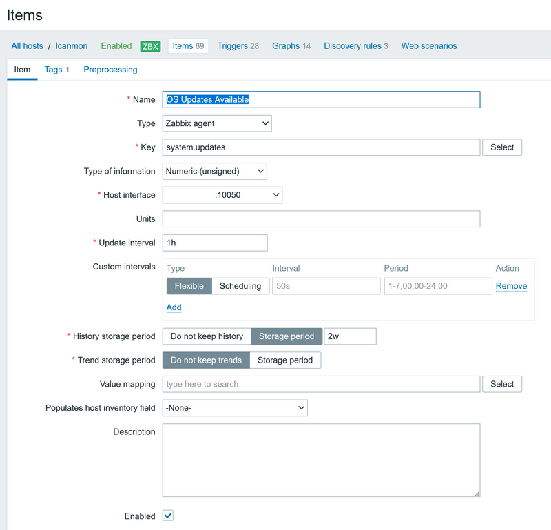

    After the test I then added the item and trigger to the zabbix dashboard for the relevant host.
    item below
    Click image for larger version  Name:	image.png Views:	0 Size:	13.9 KB ID:	499098
    Click image for larger version  Name:	image.png Views:	0 Size:	116.4 KB ID:	499096​

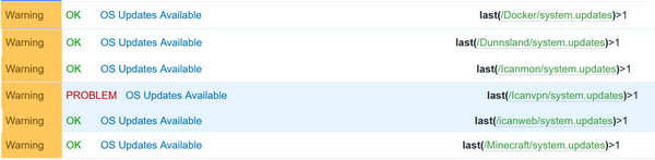

                cyber this is really confusing because I have used exactly the same syntax for all my virtual machine configs. why is it the only one shows as PROBLEM and others not.
                I have checked all the servers and they all show 1s, but I think that this syntax check is local to the config and not the check on the server.
                below is a screenshow of a few servers including the PROBLEM. As you can see the syntax of the query is all teh same.
                Click image for larger version  Name:	image.png Views:	1 Size:	52.8 KB ID:	499181
                Also I do not see any reference to the PROBLEM in the zabbix_agent.log file.
