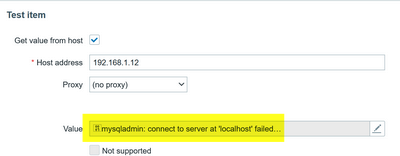

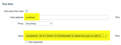

        What I am not clear on, if I open an item that is related to the zabbix_agent,
        the item always opens with the hostname being the ipaddress allocated to the VM.
        If I then change the ipaddress to localhost, then I can run the test successfully.
        if I go Configuration
        / Hosts
        / {select items for the VM in question} /
        / filter items for only mysql
        / select item type Zabbis Agent
        / select either mysql.version or mysql.ping
        / both of these items open with the ipaddress of the VM, if I run a test, both fail. See images below.
        If i then change the hostname to localhost, then both tests are successful. See images below

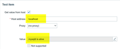

        mysql.status
        with ipaddress
        Click image for larger version  Name:	image.png Views:	0 Size:	16.7 KB ID:	499434
        with localhost
        Click image for larger version  Name:	image.png Views:	0 Size:	13.5 KB ID:	499435

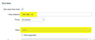

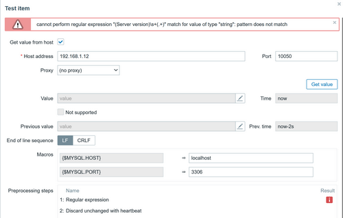

        Mysql Version
        with ipaddress
        with localhost
        Click image for larger version  Name:	image.png Views:	0 Size:	17.1 KB ID:	499437​

            The instructions uses the db user name zbx_monitor, but looking at the error below, it seems to be having issues connecting with the user zabbix@localhost. Should I add this with the necessary permissions onto teh database and not use zbx_monitor
            Preprocessing failed for: ERROR 1045 (28000): Access denied for user 'zabbix'@'localhost' (using password: NO)
            1. Failed: cannot extract XML value with xpath "/resultset/row[field/text()='Created_tmp_files']/field[@name='Value']/text()": cannot parse xml value: Start tag expected, '<' not found
            1. Failed: cannot extract XML value with xpath "/resultset/row[field/text()='Innodb_os_log_written']/field[@name='Value']/text()": cannot parse xml value: Start tag expected, '<' not found

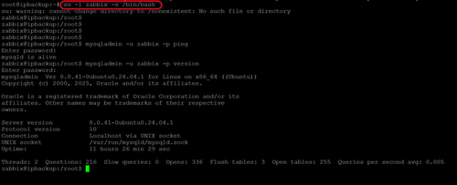

                    I have carried out my tests both as the root user running mysqladmin as the user zabbix and the user zbx_monitor.
                    Both commands connect to the database and delivered results, Only I cannot see how to run the test without using a password.
                    I also su to zabbix and ran the same mysqladmin commands successfully.
