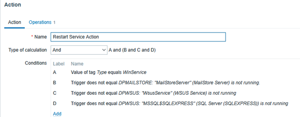

    I'm struggling with a trigger action where it is ignoring a condition.
    So a trigger action is created to restart a Windows service when Zabbix detects it's stopped.
    I added a few conditions where I don't want this to happen because I stop a service on purpose during an offline backup of a database.
    So far so good.

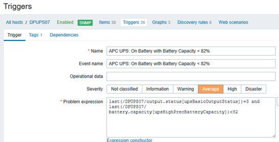

    There is another trigger action to execute a script on a host when a ups is running on battery (and capacity below a certain value).
    That is working fine as well, as a remote command a batch file is run on a specified client to stop certain services.

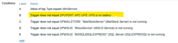

    But when I add another condition to the screenshot above so a service is NOT restarted when ups is on battery, that condition is getting ignored?
    So conditions C, D and E are working but when B is added, it is still restarting a service even though the trigger that that ups is on battery has status = problem.

    Take a look how the Type of calculation looks when you add the extra B, you didn't put that in the second screenshot so it's hard to say how it's handled. A and ( .... )
    Could it be that the UPS doesn't have a tag WinService
      Yes I had questions about that one as well so I removed all conditions other than "Trigger does not equal DPUPS07: APC UPS: UPS is on battery".
      But even with this single condition the trigger action was still restarting a service even though that ups was on battery so the condition check should have been false (at least that's what I thought).

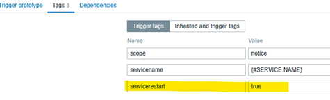

      I played around with some other options and it the end it seems I got it working:

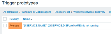

      I removed the tag "WinService" from Template Windows by Zabbix agent > Discovery rules > Windows service discovery > Trigger prototypes
      I created a new tag there "servicerestart" with value = true

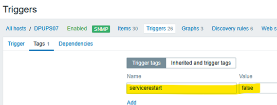

      Then on the trigger that ups is on battery with battery capacity < xx% I added that same tag but now with value = false

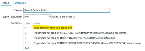

      The conditions in the trigger action now look like this:
