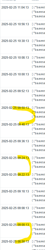

    The marked items are collected on the correct interval (2 minutes) the rest has timeouts in between. And I can't find any pattern in this. So any suggestions would be nice
