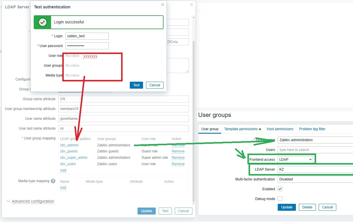

    What i really can't understand, can i set up LDAP authentication for this users at the same time at the same zabbix server?
    In the manual i see that i can set up two different LDAP hosts, but i can't see any information can this two hosts be from the different domains.
    I already set up two different hosts from the different domains but authenticaion works only from the first one, second LDAP host works when i test users, but it doesn't work when i'm trying to Log in.
    In usergroup config, there is a field for which LDAP server should be used for that group... Did you try to change to other ldap host there?
    Multiple servers
    Several LDAP servers can be defined, if necessary. For example, a different server can be used to authenticate a different user group. Once LDAP servers are configured, in user group configuration it becomes possible to select the required LDAP server for the respective user group.
    If a user is in multiple user groups and multiple LDAP servers, the first server in the list of LDAP servers sorted by name in ascending order will be used for authentication.

      I really missed that, but i did that and unfortunately this does not help. What more can i check? I see that i can pass the login test, but the user don't find any group.

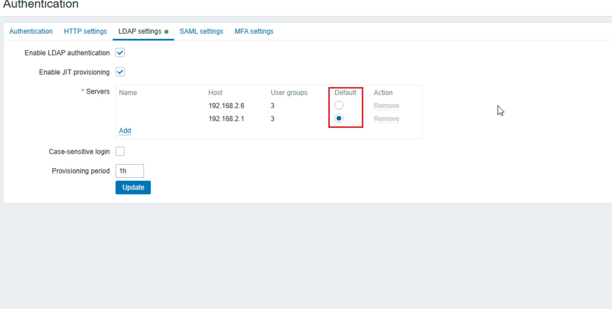

          I already made two servers for two those domains in Authentication setting, but i have two problems:
          1) When new users connecting to Zabbix for the first time only the users from Default server are working (can logon).
          So every time a have a new user a i have to change the Default setting to another server. Then everything working fine until step 2.
          2) After any user change the password Zabbix allow to logon user with OLD and NEW password at the same time.
          So my questions is:
          1) Can i somehow fix the problem 1?
          2) Is the behavior at step 2 is normal for Zabbix?
