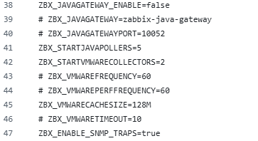

        • Brambo
          • Jul 2023
          • 256
          What we do with docker compose file is: (i only add partial code)
           volumes:
             - /etc/localtime:/etc/localtime:ro
             - ./zbx_env/usr/lib/zabbix/alertscripts:/usr/lib/zabbix/alertscripts:ro
             - ./zbx_env/usr/lib/zabbix/externalscripts:/usr/lib/zabbix/externalscripts:ro
          env_file:
          - ./env_vars/.env_db_mysql
          - ./env_vars/.env_srv​
          In the .env_srv we have all ZBX_xxx variables setup.
          And that file you can set values the way you want. (by hand or external tooling)
          And the file should look something like this (without line numbering of course )

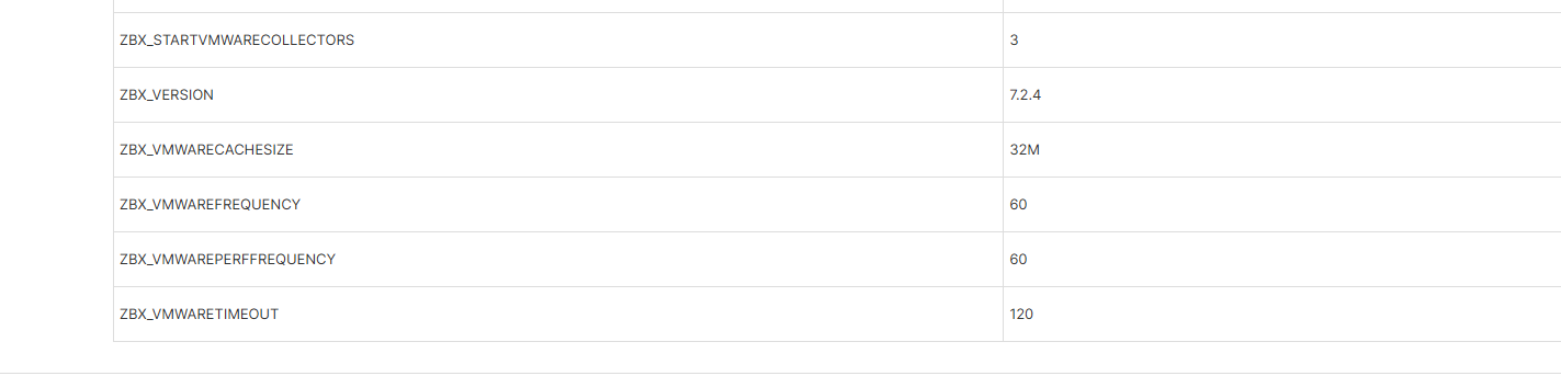

            • einsteinagogo
              • Feb 2025
              Okay, still not finding that the variables are being updated in the correct .conf file.
              they are definately present in the entropy.sh , just not being acted upon.
              So removing environmental variables from portainter, end env files.... this is my docker compose in the stack
              zabbix-server:
              image: zabbix/zabbix-server-pgsql
              container_name: Zabbix-SERVER
              ports:
              - 10051:10051
              environment:
              DB_SERVER_HOST: postgres
              DB_SERVER_PORT: 5432
              POSTGRES_DB: zabbix
              POSTGRES_USER: zabbixuser
              POSTGRES_PASSWORD: zabbixpass
              ZBX_STARTVMWARECOLLECTORS: 3
              ZBX_VMWAREFREQUENCY: 60
              ZBX_VMWAREPERFFREQUENCY: 60
              ZBX_VMWARECACHESIZE: 32M
              ZBX_VMWARETIMEOUT: 120
              the first variables DB server etc are working okay, but the ZBX variables are not being written to the zabbix_server_vmware.conf ?
              there are present, so this is not an env issue, something in the build is not passing the variables, or I've got the wrong variables ?

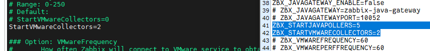

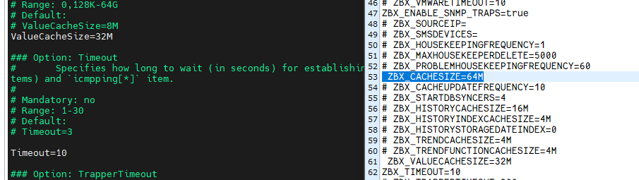

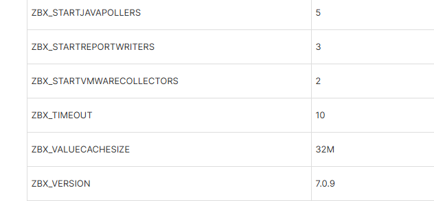

              • Brambo
                • Jul 2023
                • 256
                Well in my situation all .env_srv are parsed into the zabbix-server.conf (in /etc/zabbix) (left cat on the file / right content of the env file)
                So I do think something is going wrong, are you looking in the correct container? Even in portainer the env variables are shown correct Click image for larger version
