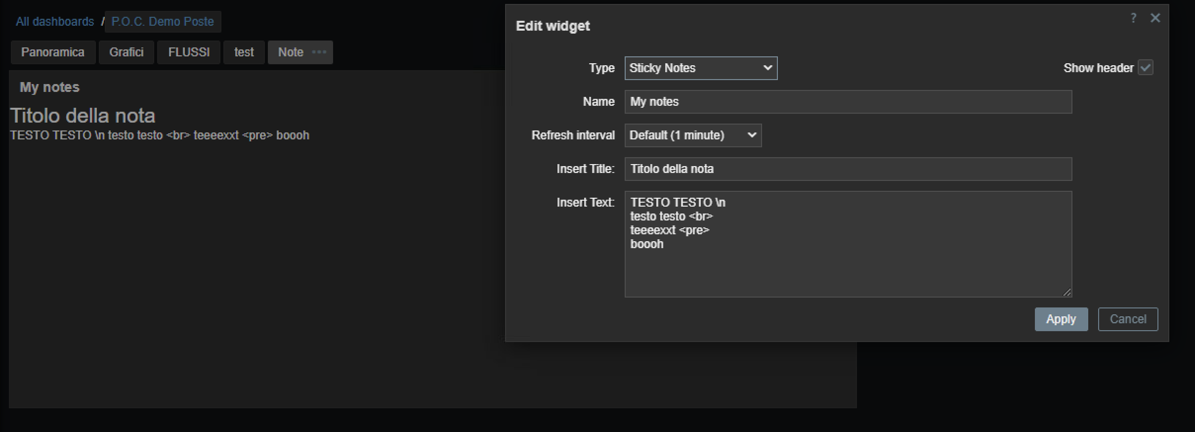

    I attach a screenshot
    Click image for larger version  Name:	image.png Views:	6 Size:	48.4 KB ID:	499600
    How I can do that?
    here the essential lines:
    views/widget.edit.php: new CWidgetFieldTextAreaView($data['fields']['testo'])
    includes/WidgetForm.php: use Zabbix\Widgets\Fields\CWidgetFieldTextArea;
    includes/WidgetForm.php: new CWidgetFieldTextArea('testo', _('Insert Text:'))

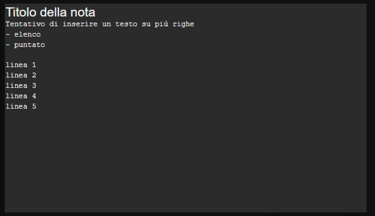

    And this is the result I want:
    Thank you anyway
          Thank you anyway
