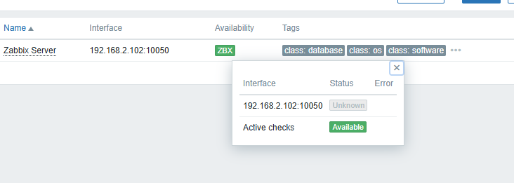

      I have my Zabbix server configured as in the firat screenshot. Is it normal then for the server to show an unknown status, as in the second screenshot? I am trying to get a baseline of agents to use on a normal 3 tier Linux server. Click image for larger version

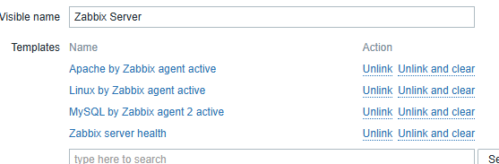

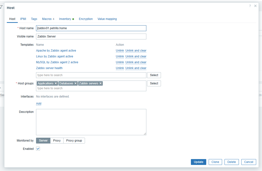

        What I found is that I do not need to specify the interface information, when using the active agents. That is quite interesting... Click image for larger version

          Generally, I would use Agent2. I wouldn't bother using the previous version of agentd unless there is some extreme niche use not documented by Zabbix.
          As for information and interfaces when using Agent2 in active mode: Yes, this is true. That's because the system is pushing its FQDN when sending the data to Zabbix which is matched against the list of hosts being monitored. Agent2 also (as of 7.0) has full support for active command execution as well. If you're below 7.0 you will need to specify the interface (<IP/FQDN>:10050) for command execution to work.
