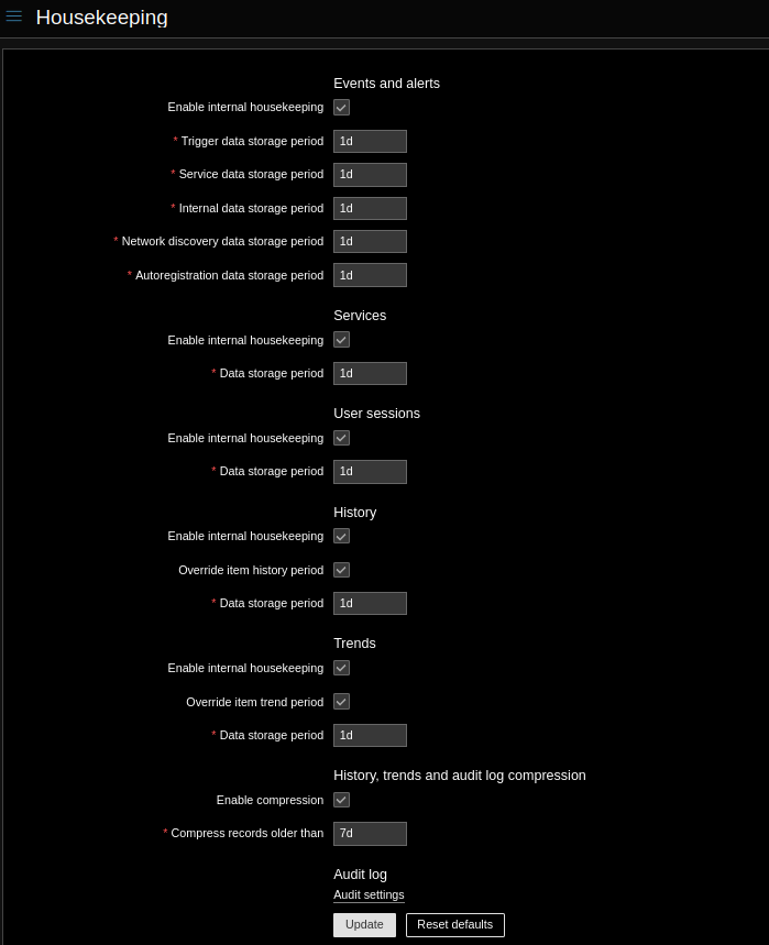

          Also, I have to add that, in the GUI, in the housekeeper section, all fields were changed to 1 day.
          Click image for larger version  Name:	1.png Views:	0 Size:	59.2 KB ID:	500390​
          What options can you suggest? Should we truncate all the tables you mentioned one by one?
