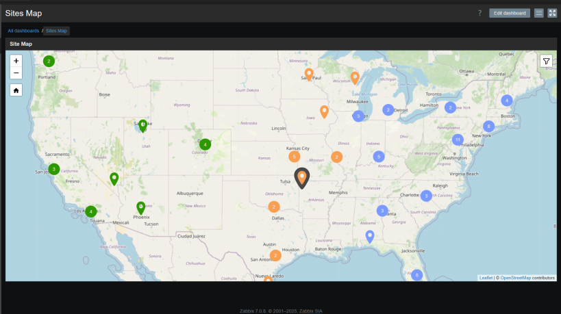

    Hello Zabbix community,
    I am using Zabbix Geomap widget to plot all of my business locations, but when I am at zoom level 5 to have a nice view of the entire U.S a lot of my pins are being clustered together. Is there a way to modify the Geomap clustering?
    For example in the map below I have a site in NSH, Tennessee but its being clustered with Kentucky sites.

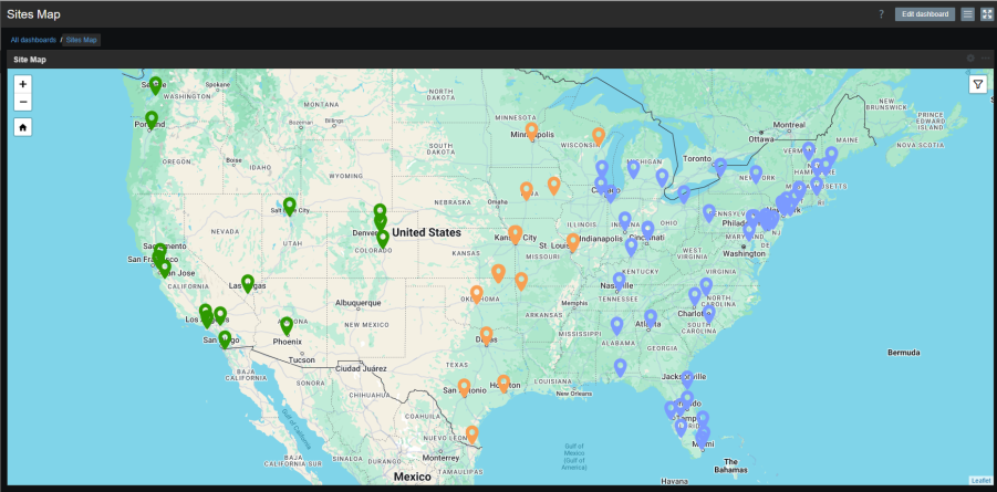

    mbedsun
    • Mar 2025
    I fixed my issue.
    On your Zabbix server look for this file /usr/share/zabbix/widgets/geomap/assets/js/class.widget.js.
    using sudo vi you can the search for the starting code "/_createClusterLayer()"
    example code that you should see.
    _createClusterLayer() {
    const clusters = L.markerClusterGroup({
    showCoverageOnHover: false,
    zoomToBoundsOnClick: false,
    removeOutsideVisibleBounds: true,
    spiderfyOnMaxZoom: false,
    iconCreateFunction: (cluster) => {
    const max_severity = Math.max(...cluster.getAllChildMarkers().map(p => p.feature.properties.severity));
    const color = this._severity_levels.get(max_severity).color;
    return new L.DivIcon({
    html: `
    <div class="cluster-outer-shape">
    <div style="background-color: ${color};">
    <span>${cluster.getChildCount()}</span>
    </div>
    </div>`,
    className: 'marker-cluster',
    iconSize: new L.Point(50, 50)
    return clusters;
    Modified the code by adding the two settings below highlighted in BOLD font.
    maxClusterRadius: 40, // Reduced from default 80 to 40 to prevent excessive clustering
    disableClusteringAtZoom: 7, // Clusters break apart sooner
    html: `
    </div>
    </div>`,
    return clusters;
    Save this and restart your web service (Apache2 or Ngnix) and then reload your dashboard page with your geomap widget.
    AFTER
