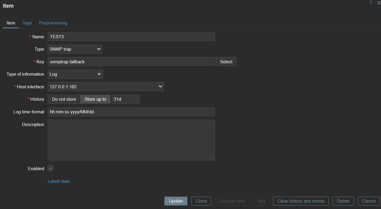

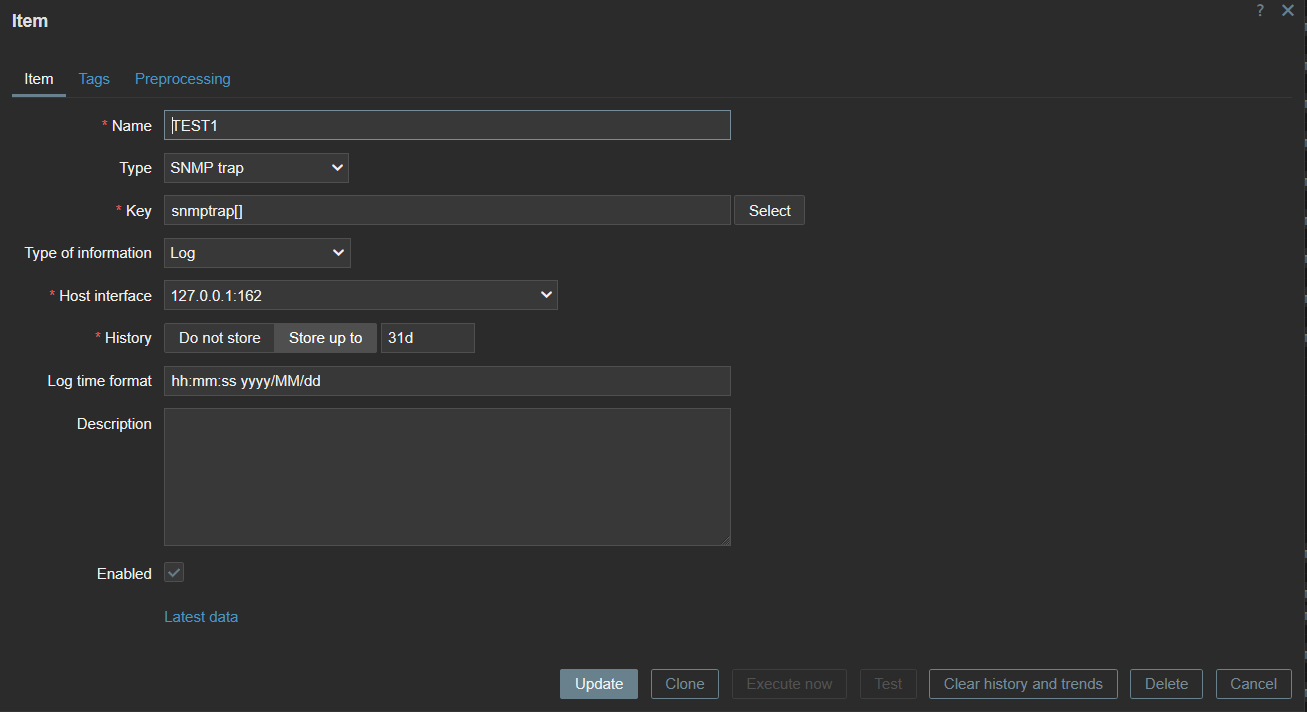

      In the settings, I disabled the community to accept all traps and configured the item host as follows:

        • 5002
        https://www.zabbix.com/documentation...types/snmptrap Configuring SNMP traps
        This item type requires the following frontend configuration.
        1. Create an SNMP interface for your host
        • In Data collection > Hosts, create/edit the host, and in the Interfaces field, add the interface type "SNMP", specifying the IP or DNS address.
          The address from each received trap will be compared to the IP and DNS addresses of all SNMP interfaces to find the corresponding hosts.
        So your testing from your zabbix server works probbly because of 127.0.0.1...
        and fallback does not catch those coming from outside... (That interface is 127.0.0.1 at the moment)
        snmptrap.fallback
        Catches all SNMP traps that were not caught by any of the snmptrap[] items for that interface.
        you need to create a host with the correct IP/DNS in interface config...

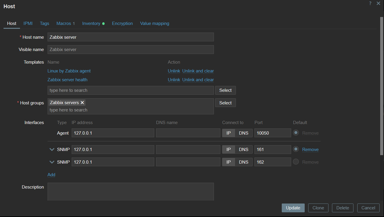

        • Anton Semashka
          • Jan 2025
          I need to set up a host for the zabbix server in the interfaces not 127.0.0.1, but its address looking into the network?
          Or create a host with ip from which traps are sent?
            • 5002
            Thats what I said...
            • Anton Semashka
              • Jan 2025
              Thank you. It actually worked. There was probably a mistake in the instructions.
