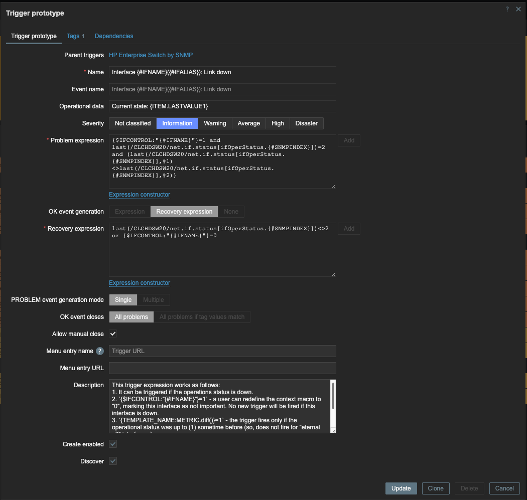

    Trigger Not Changing Severity
    I have changed the template for Aruba Enterprise switches to make the interface down message go from Warning to Informational. When I did this I was expecting the status to change but it did not. When I go into the individual trigger it is updated by the template, but on my dashboard the triggers are still warnings.

    I believe they are only updated on new execution of the discovery rule.
    So your host triggers will get the update but only after a run of the discovery rule and only then the dashboard/ problems will be updated.
