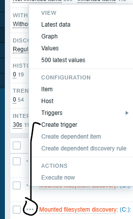

      easy option 2: Click image for larger version
      In your template or host item, click the 3 ... before and choose create trigger. This option is a little bit harder as you have to change func to the correct function you want to do
