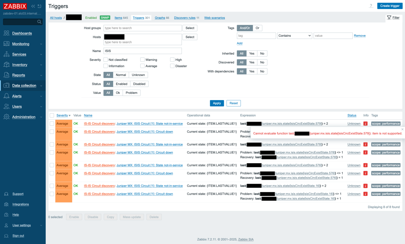

            Now, I've got a new problem. For each of the detected IS-IS circuits, when I go to look at the triggers I defined, I'm now getting the error:
            Cannot evaluate function last(/hostname/juniper.mx.isis.state[isisCircExistState.579]): item is not supported.
            I will upload an attachment showing what that looks like in the WebUI, with the hostname redacted:
            IS-IS Triggers not working
            • BradKnowles

              But I'm not understanding what "Item is not supported" means.
              • ISiroshtan
                ISiroshtan commented
                Check not the tirgger status but instead discovered items status. They usually show why items is becoming unsupported.

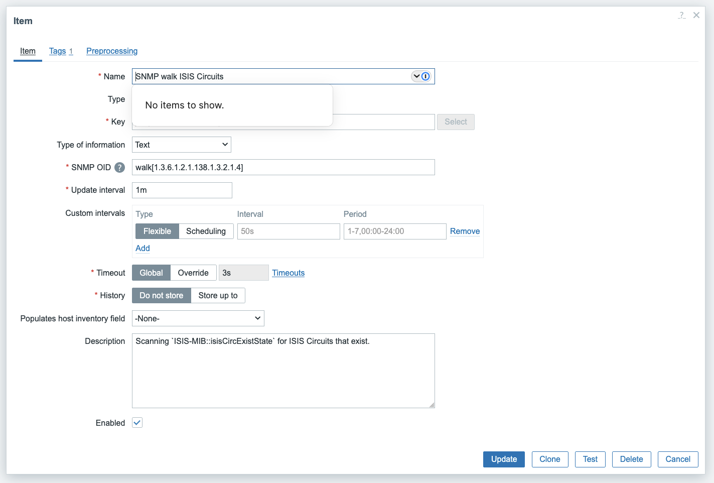

              And here is the raw master item that I created:
              Raw master item for IS-IS Circuit state

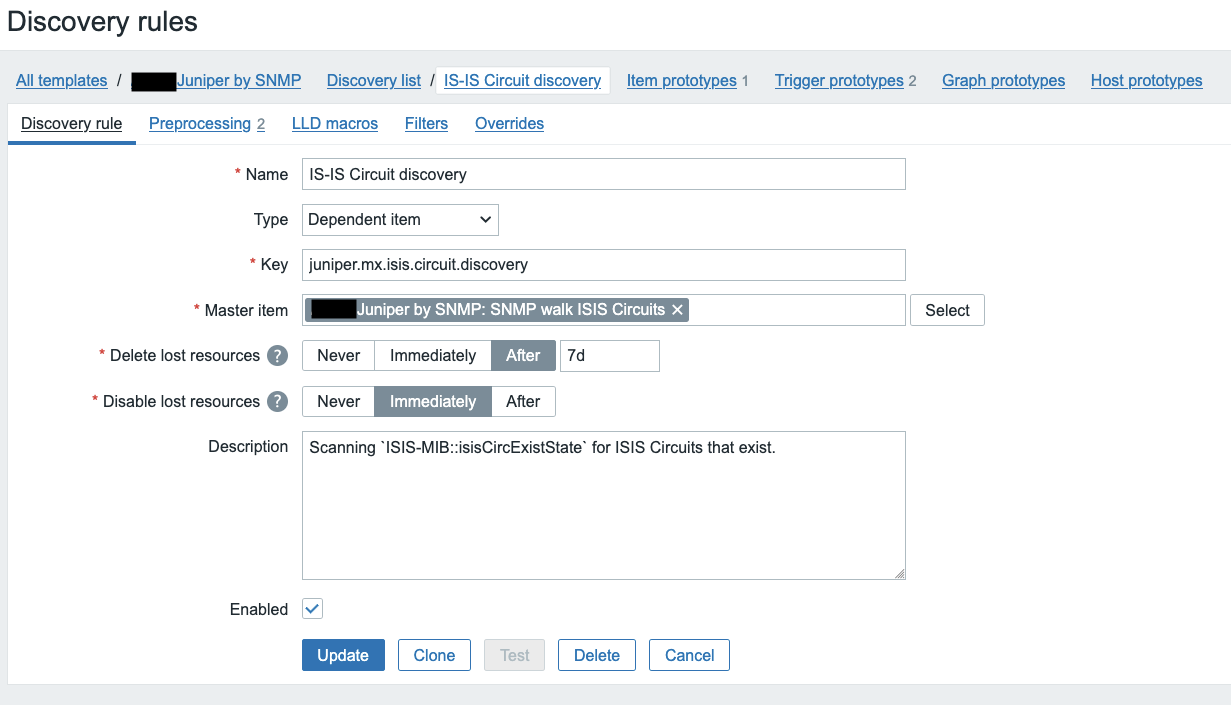

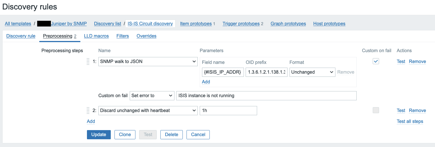

                Here is the discovery rule I created (based on the OSPF example in the Juniper MX by SNMP template), with part of the template name redacted:
Name:	Screenshot 2025-08-20 at 1.53.46 PM.png
                And here is the pre-processing rules that I created (also based on the OSPF example):

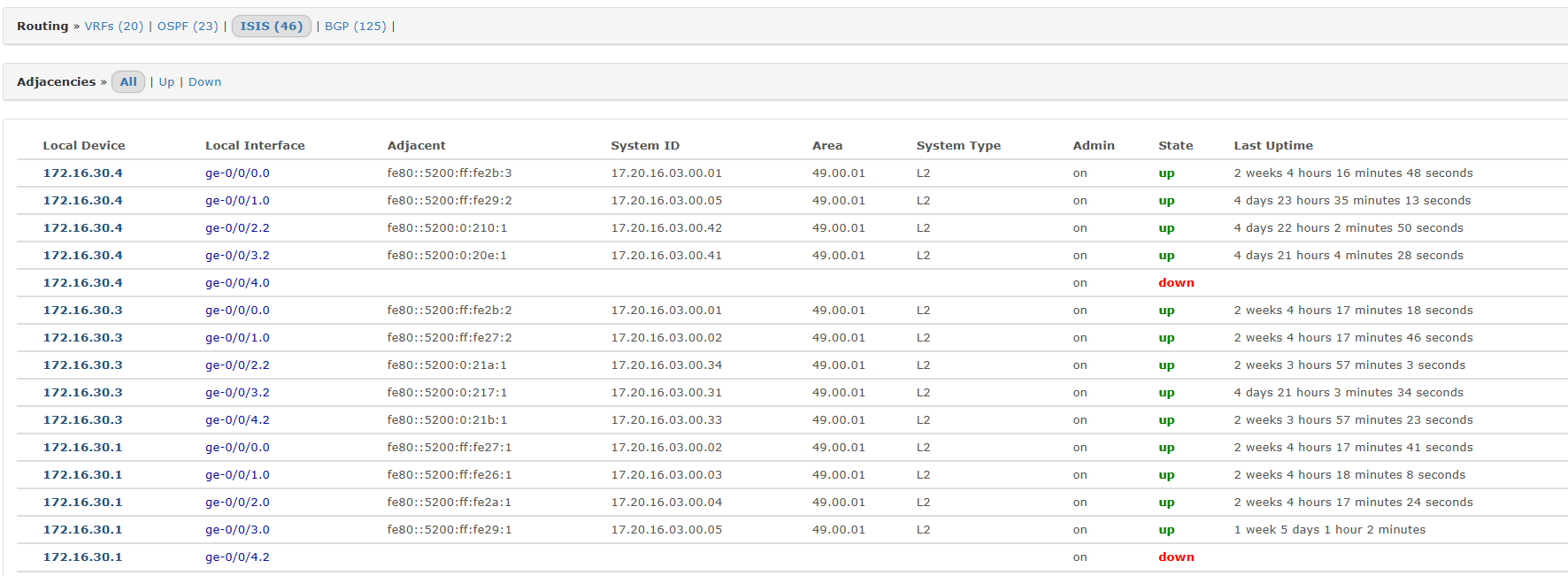

                • kronicklez
                  • Mar 2025
                  • 54
                  In the librenms its capable to monitor ISIS as per below snapshot. But is it possible zabbix can do similar like this?

                  • ISiroshtan
                    Can you collect all the same data? - yes.
                    Is there pre-made template for it? - seems like no and you would need to build it from scratch
                    Can you present data exactly like this? - I'm not sure. I've stopped using Zabbix data visualization for majority of cases and instead build Grafana dashboards using data from Zabbix. With such approach - definitely yes, you could build similar visualisation.

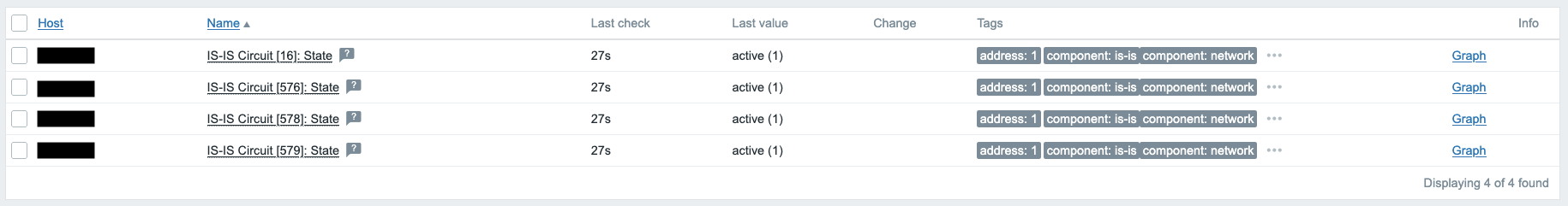

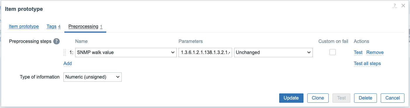

                  Okay, I think I figured out my problem. I had updated the OID for the IS-IS Discovery dependent item itself, but I had not updated the OID for the Item Prototype under that dependent item. Here's what that looks like now:
                  Click image for larger version  Name:	Screenshot 2025-08-21 at 3.09.44 PM.png Views:	0 Size:	49.5 KB ID:	506438I can see the status coming through:

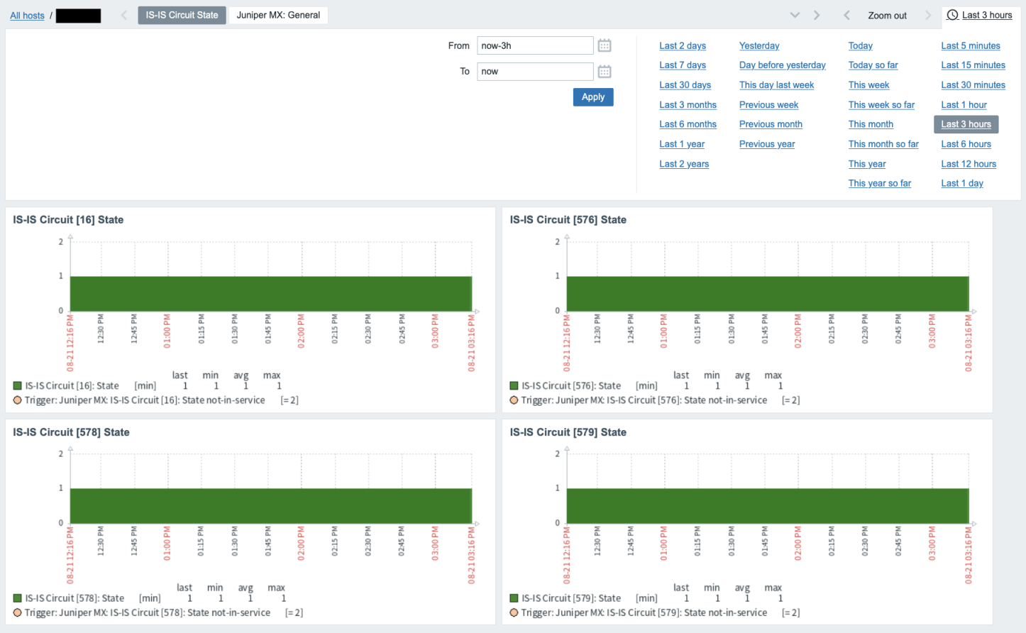

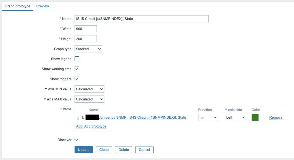

                  Click image for larger version  Name:	Screenshot 2025-08-21 at 3.15.00 PM.png Views:	0 Size:	56.8 KB ID:	506439I've created a Graph Prototype that enumerates all the circuit numbers:

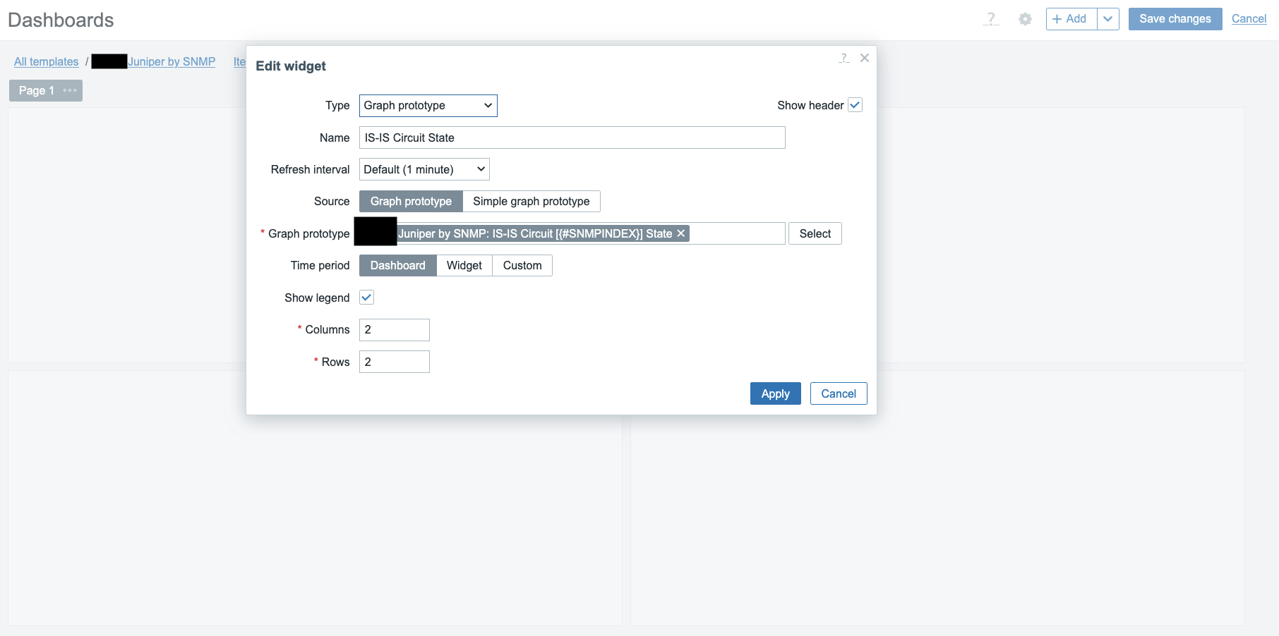

                  Click image for larger version  Name:	Screenshot 2025-08-21 at 3.14.36 PM.png Views:	0 Size:	59.0 KB ID:	506440I've created a dashboard on the template that references this Graph Prototype, which looks deceivingly empty:
                  Click image for larger version  Name:	Screenshot 2025-08-21 at 3.16.26 PM.png Views:	0 Size:	88.2 KB ID:	506441And this now shows up as a host level dashboard for the system where I've been doing my testing:
                  Click image for larger version  Name:	Screenshot 2025-08-21 at 3.17.06 PM.png Views:	0 Size:	277.8 KB ID:	506442Now I need to figure out things like how to identify which SNMP Index belongs to which circuit that may be better known by some other criteria, like the interface it's on, the IP address(es) associated with it, or whatever.
                  And it would be great if I could get them all stacked onto the same larger graph, instead of multiple smaller graphs. Because I've got only so much space on this dashboard, and there's a lot of overhead here. I don't know how many IS-IS circuits we may be dealing with in production.
