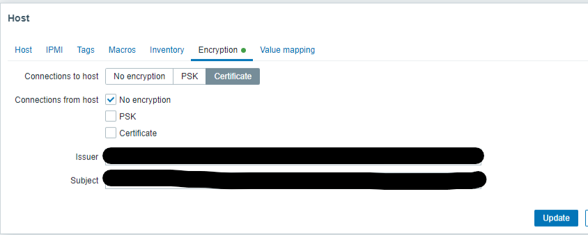

    We try to implement a secure communication between our zabbix server and zabbix agent (only server to agent), according to the documentation we implemented the following configuration on :
    - Zabbix Agent
    TLSAccept=cert
    TLSCAFile=Our certificate CA
    TLSCertFile=Our certificate file
    TLSKeyFile= Our certificate key
    - Zabbix server
    We activate Certificate Encryption with the Issuer and subject chain that match with the Zabbix Agent Certificate
Name:	Annotation 2025-03-24 171440.png
    After this configuration we still have an error => cannot connect with TLS and certificate : no valid certificate loaded
Name:	Annotation 2025-03-24 171637.png
    On Zabbix Agent we have => failed to accept an incoming connection: from xx.xx.xx.xx : unencrypted connections are not allowed
    All the CA are installed on zabbix server, zabbix agent certifcate match with the key.
    we also test with openssl a connection to the agent on zabbix server with succes
    openssl s_client -connect host_ip_zabbix_agent:10050 => OK
    Do we miss something ?

    What if you add TLSServerCertIssuer and TLSServerCertSubject to your agent config, does that work ?
    Regards
