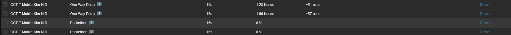

    We utilize a lot of Accedian NID's in our environment (GT,TE,LT,LX, etc). I've been looking into getting one-way, two-way, and packet loss information that gets recorded when setting up a PAA test between to accedian devices. I have a basic template that works, it'll pull via SNMP those values and graph them in zabbix. The issue I'm running into is a good way to implement either test name or vlan # to allow it to differentiate between multiple tests on the same device. As you can see in the screenshot I attached I have 2 tests running on a single device they have different names and use different vlans but the way my template is setup now I can't differentiate between the 2. I'm not super familiar with building templates so if there's a better way to do this or if someone else is also tracking those test results in their environment I'd be curios to know what to do better. I'll also attach an export of my template, any help of this would be greatly appreciated.

    Try to use buit-in Macros like {HOST.CONN} and others in the Item name

          Use Zabbix Low Level Discovery (LLD) to solve this. Create a discovery rule that walks the SNMP OID table for PAA tests, then use the test name or VLAN ID as a macro like {#TEST_NAME} or {#VLAN_ID} in your item prototypes. This way Zabbix automatically creates separate items and graphs for each test on the same device without any manual changes to your template.
