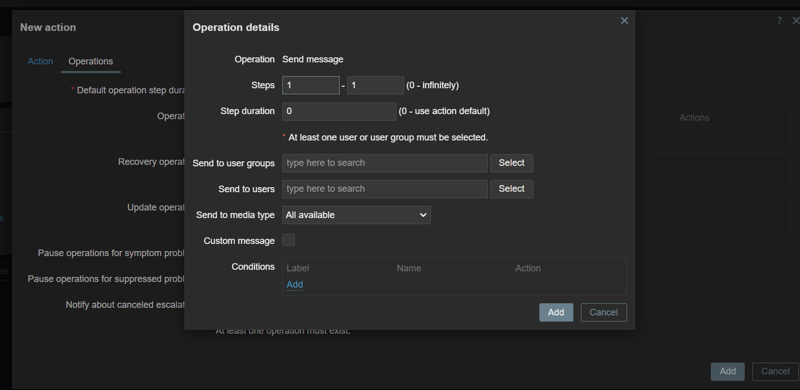

    Is it still possible to run remote commands? Zabbix 7+ agent 2 or agent 1
    I' m trying to enableremotecommands=1
    But no success with zabbix 7.2 / agent 2(windows 11pc)
    I don't see anywhere in the UI for triggers
    I only see Send Message
    any help would be greatly appreciated

    Well it depends what you want to accomplish, trigger a command on a host or send a message to someone.
    Yes you can use EnableRemoteCommand although this parameter is deprecated. Instead use AllowKey or the UserParameter parameters in your agent configuration file.
    To trigger a command on a remote host enable it in the agent configuration file like
    ### Option: AllowKey
    AllowKey=system.run["net start *",*]
    AllowKey=system.run["net stop *",*]
    ### Option: DenyKey
    DenyKey=system.run[*]
    In the case above you can start/stop services from you zabbix server.
    The screenshot you posted is for sending message to user of usergroups when something happens.
    Regards
