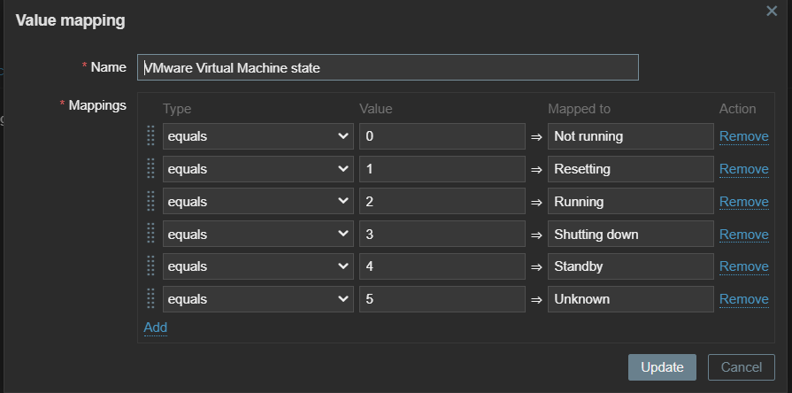

      That trigger is edited by someone and completely screwed up .. "last(/host/item,#3)..." means 3rd value from the end... So it triggers 3 minutes after something has happened...
      Original should be
      last(/VMware Guest/vmware.vm.state[{$VMWARE.URL},{$VMWARE.VM.UUID}]) <> 2
      there is no state for vmotion... there are
      I guess during host migration you get not running from one host and running fro another? I am not much of vmware specialist..
