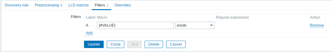

    I don't have any unsupported elements.
    I created a filter in the Discovery rule:
    {#VALUE} 1.3.6.1.4.1.9.9.91.1.1.1.1.4

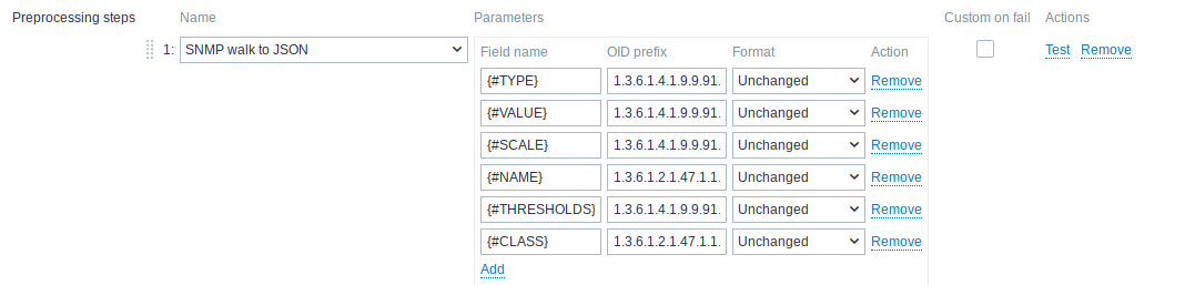

      Just as an addition to rusadm answer, if {#ENTPHYSICALDESCR} exists in your JSON but has no value, you can also try this filter:

        • kyus
          • Feb 2024
          • 203
          #19
          That's why the filter was created, that way you only get items if the macro was populated.
          You can add more filters if you need
