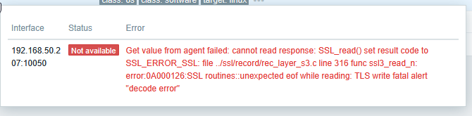

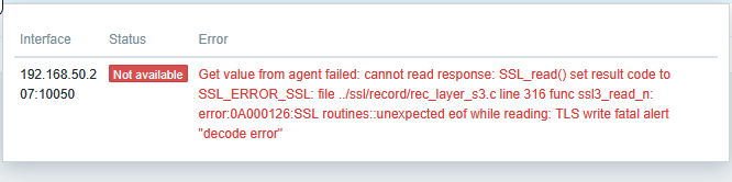

      I did the same thing on a test redhat client and its service also starts up normal. But now i get a different error (screenshot below)

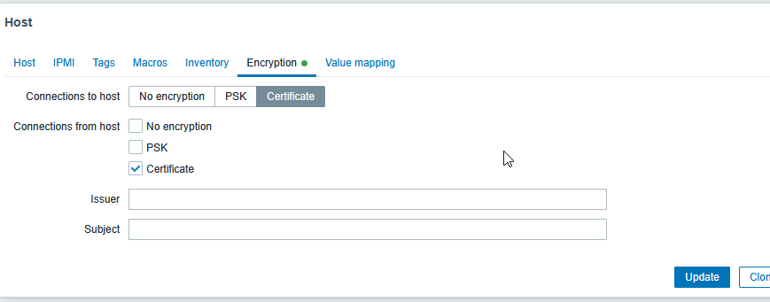

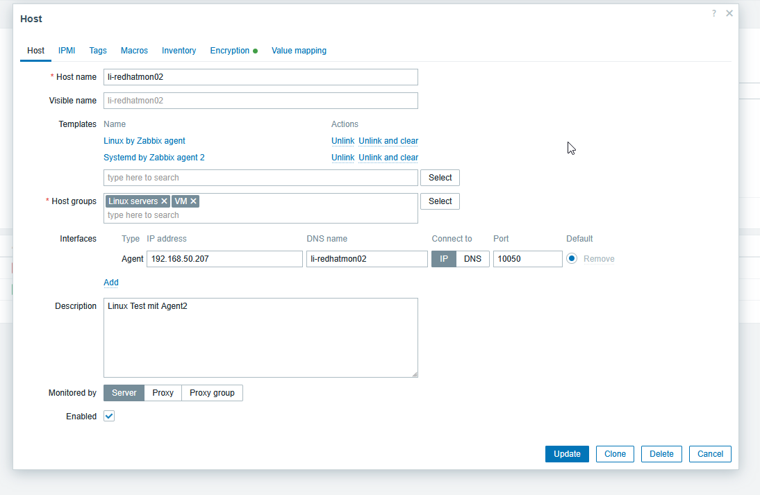

      This is how i have the host configured in the Zabbix gui:

      I think it really doesnt like the .cer file or did I go wrong somewhere else? I will try to find out later today.

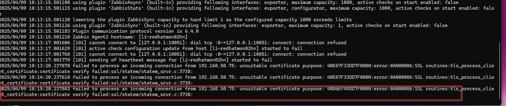

        tail -f /var/log/zabbix/zabbix_agent2.log on the host reveales this:
        Click image for larger version  Name:	grafik.png Views:	0 Size:	94.6 KB ID:	501636
        So it appears theres still something wrong with the certs. Any idea what that problem might be?

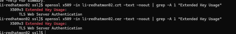

        edit: This is what i´ve found since:
        I guess that might be part of the issue?
