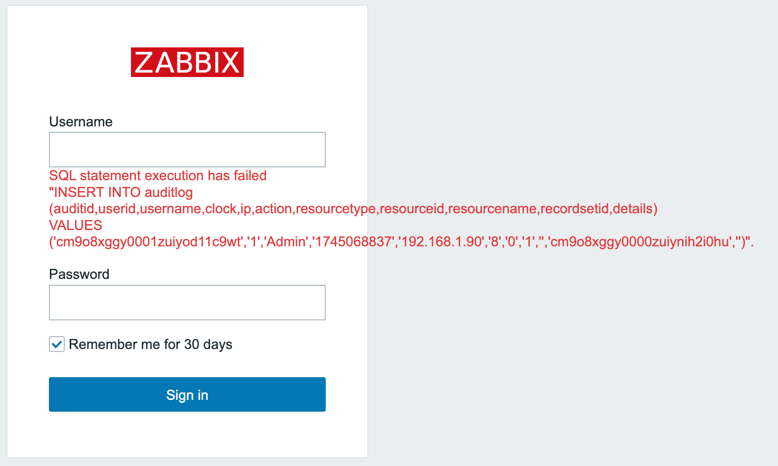

    but it appears that most of the data is there (I can see data in DBeaver). When I attempt to login I receive
    SQL statement execution has failed "INSERT INTO auditlog (auditid,userid,username,clock,ip,action,resourcet ype,resourceid,resourcename,recordsetid,details) VALUES ('cm9o8xggy0001zuiyod11c9wt','1','Admin','17450688 37','192.168.1.90','8','0','1','','cm9o8xggy0000zu iynih2i0hu','')
    I can't login to the UI and this does not seem to be a password issue. This is the corresponding message in postgres
    2025-04-19 08:40:11.549 CDT [48506] zabbix@zabbix ERROR: invalid INSERT on the root table of hypertable "_hyper_7_1189_chunk"
    2025-04-19 08:40:11.549 CDT [48506] zabbix@zabbix HINT: Make sure the TimescaleDB extension has been preloaded.
    2025-04-19 08:40:11.549 CDT [48506] zabbix@zabbix STATEMENT: INSERT INTO auditlog (auditid,userid,username,clock,ip,action,resourcet ype,resourceid,resourcename,recordsetid,details) VALUES ('cm9o9mmj70001q9iyzi6trwzk','1','Admin','17450700 11','192.168.1.90','8','0','1','','cm9o9mmj70000q9 iyu2ux80ri','')​
    I'm stuck. I seem to be able to recover the data, but I can access the UI.
