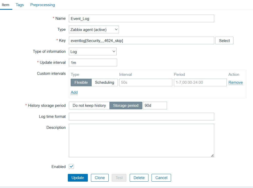

    My zabbix server Version 6.0
    The settings are as follows

    The following settings have different results:

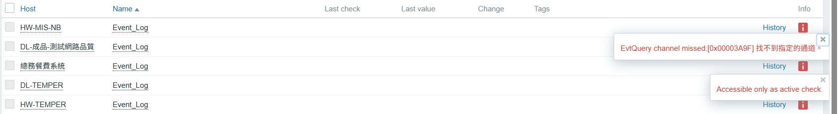

    Result after execution:
    If zabbix_agentd.conf is configured, the result is as follows: Accessible only as active check.
    If you change the default value of zabbix_agentd.conf to:
    1. Log Type = System
    2. Server = 192.168.5.243
    3. HostnameItem=system.hostname[host]
    4. Server Activity = 192.168.5.226,

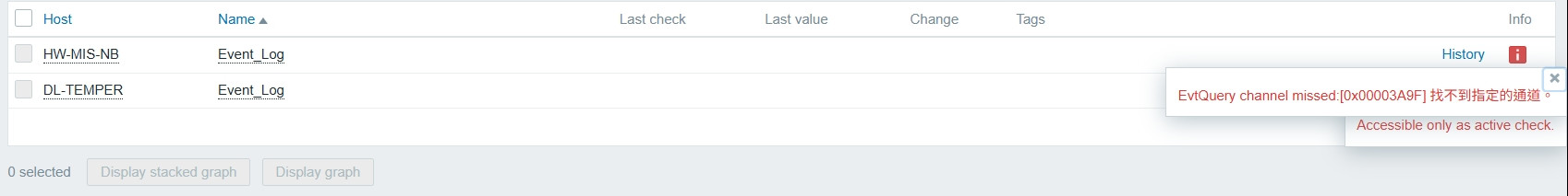

    The result is as follows: EvtQuery channel missing: [0x00003A9F] The specified channel cannot be found.
    As a result, the contents of my event log cannot be displayed properly.
    How should I fix this problem?​​

    This seems to be the same issue as this: https://www.zabbix.com/forum/zabbix-...d-not-be-found
    Its an Eventlog-error, so your Active Agent config is fine.
    Something about the key is not quite right. Maybe try adding a source as in the linked thread..
