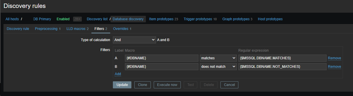

    The first thing to do is to establish a connection to your database. Any of the available options here can help you with that. https://www.zabbix.com/integrations/mysql
    The templates the options come with are not exactly what you are asking for, but they are full of good examples of how Zabbix mechanics work.

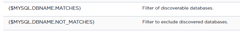

    " MySQL by Zabbix agent" comes with these macros that limit which databases is will discover, and if you look at how the discovery uses these I'm sure you can fluff the config to suit your needs.
