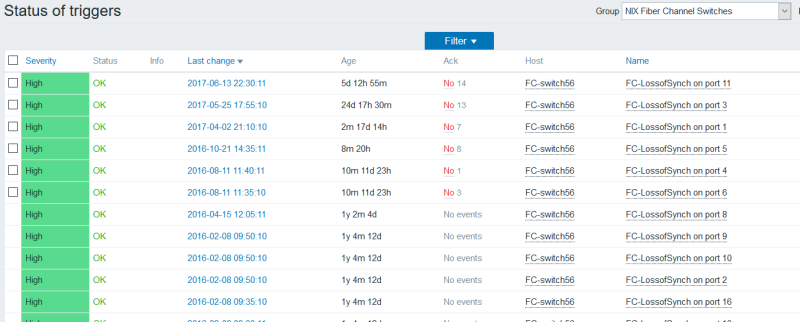

      In my understanding (please challenge this and let me know what you find), triggers don’t actually have a date, but they do have a ‘last changed’ value.
      A “trigger” is just an expression used to evaluate inbound metrics as either OK or PROBLEM. The triggers table happens to record the current state of each configured trigger, and the timestamp at which the trigger state last changed. This is what the Triggers view in Zabbix is showing you - the time of the most recent change, and a link to the most recent associated ‘event’, if it still exists.
      Here is the last-changed field in the Zabbix sources: https://github.com/zabbix/zabbix/blo...hema.tmpl#L595.
      You’ll notice the events table actually has a timestamp for each event: https://github.com/zabbix/zabbix/blo...ema.tmpl#L1045
      The relationship between triggers and events is one-to-many. There could be multiple events for each trigger and all triggers are all unique. The most recent event for a trigger should coincide with the last-changed value of the trigger.
      Effectively your triggers are not “old” - they are current and still being used to evaluate inbound metrics. They just haven’t changed state in a long time. The details of the most recent change, i.e. the “event”, may have been truncated in your partitioning process.
      Please note that partitioning is not supported by Zabbix, and software updates do break partitioned installations from time to time. There is however, a reasonably size community of people who can help (myself included).

        I may need to clarify what I mean by "old triggers". Below is a screen snapshot from Zabbix. The filter has been set to have a Trigger Status of "Any", instead of "Recent Problem", to show a complete list of entries related to the trigger.
        It is clear that we are removing events old than a year, because any Last Change entries older than a year have no events associated with it. In our case a simple SQL statement is used to remove events older than a year each week. This was per the "Mastering Zabbix, 2nd Edition" manual.
        My concern is regarding the entries in the triggers table that are older than a year. Seems like that table is going to continue to grow unbounded. We have housekeeping disabled. But my offline testing of housekeeping didn't appear to remove entries older than a year in this Triggers screen (triggers table).
        Sorry if I'm being dense on this one, maybe those entries don't need to be removed. But just want to keep the database as clean as possible, since it is so crucial. Very much appreciate any feedback.
