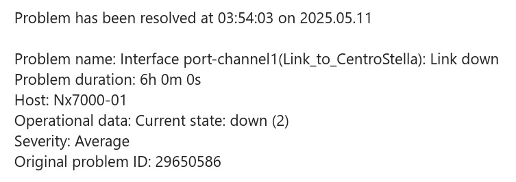

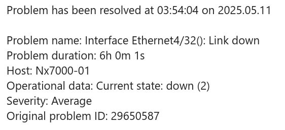

    After 6 hours however without any intervention at all, I received the "RESOLVED" message for both the port and the portchannel, but it says :
    As you can see, the Current State is down so I didn't expected for the alarm to resolv
    Also the port-channel resolved:

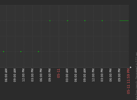

      The item history don't look strange too:
      It clearly shows that there has been a change and nothing more.

        Note that the trigger uses only "and" operations.
        It will only become true (create an event) if there is a change on the interface (oper) status going from something to down (2), also the control macro must be 1.
        On your second picture, the partial graph, I can't see the actual values, so I assume the interface current status is not 2. It looks more like 3, which resolves the event.
        • Pigi_102
          • Sep 2021
          • 39
          Unfortunally not, the link state is 2 ( down ).... that's why I was asking....
