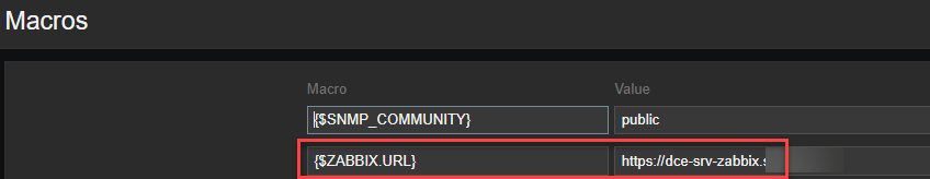

              I've added the Macro:

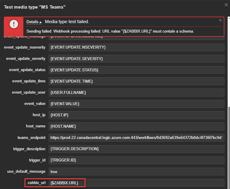

              It says it must contain a schema:

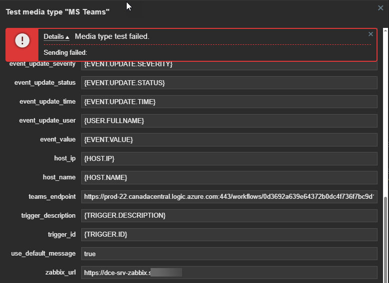

              When I manually enter in the Zabbix URL -- Sending failed:

              00:00:00.000 [Debug] [MS Teams Webhook] Source: Discovery; Event: null00:00:00.000 [Debug] [MS Teams Webhook] Sending post request:"{"themeColor":"1F1F1F","summary":"{ALERT. SUBJECT}","sections":[{"markdown":"false","activityTitle":"{ALERT.SUBJEC T}","text":"{ALERT.MESSAGE}"}],"potentialAction":[{"@type":"OpenUri","name":"Zabbix Home","targets":[{"os":"default","uri":"https://dce-srv-zabbix.redacted.com"}]}]}"00:00:00.512 [Debug] [MS Teams Webhook] Response has been received:00:00:00.512 [Warning] [MS Teams Webhook] FAILED with response:00:00:00.512 [Warning] [MS Teams Webhook] notification failed:

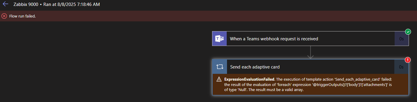

                What does it say in Teams > (left side 3 dot menu) > Search for "Worksflows" > Select the 3 dot menu next to your Zabbix flow > Run History > Select the recent one > Run Details. I don't have any answers, I'm just wondering if you have the same error as me across the Pond. I'm thinking that Microsoft changed how the webhooks run and the guides and tutorials that we are following are now outdated.Click image for larger version

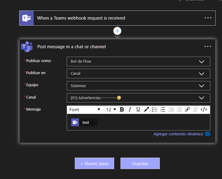

                  this is working for me to send alerts via MS Teams
                  The trigger expresion is === triggerbody()?['text']
                  at least this is the only configuration that i did on the webhook configuration​​
