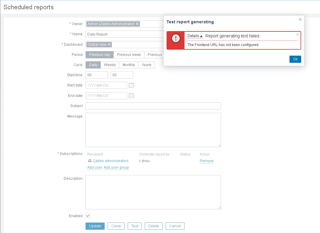

    Dear all,

    When I navigate to the web portal: Reports -> Scheduled reports select one and click the Test button, it gives me an error:
    Report generating test failed.
    The frontend URL has not been configured.
    So, what steps should I do to normally generate the reports?​
