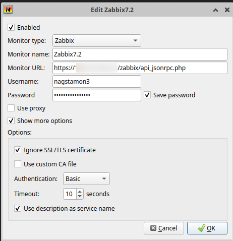

    Here is a screenshot of the settings that I've used:

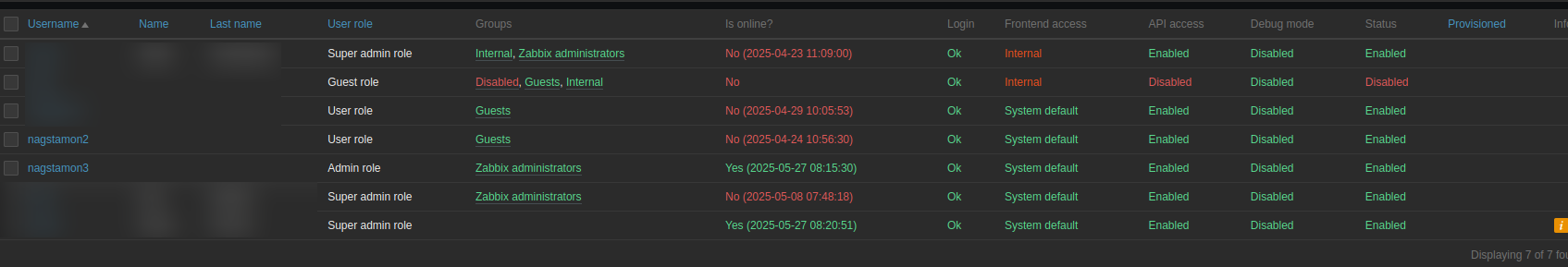

    here is a screenshot of the user in the zabbix dashboard
    I've tried to use chatgpt in order to solve this issue but

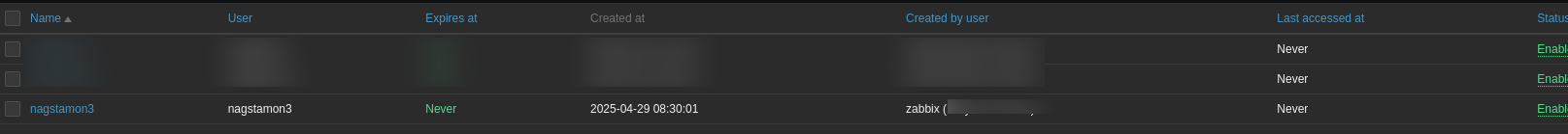

    here is from API area

    In order to make sure that there is no issue with my zabbix user I have added it to ZabbixVue extension (through API key)
