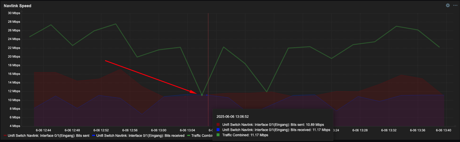

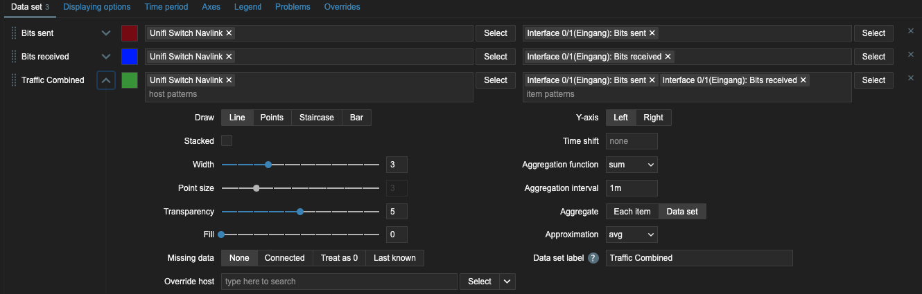

    My questing is about an aggregated Graph.
    I am getting the Bit Send / Received via SNMP from a Switch.
    Now I want to display 3 Plots (Lines) on the Chart Widget
    - Bits Send
    - Bits Received
    - Bits Send + Bits Received
    Its working but not perfect.
    It looks like that sometimes Send and Received are not reported at the same time. As you can see in the screenshot below, the green line is not correct at some points.

    Is there a way to improve the calculation ?
