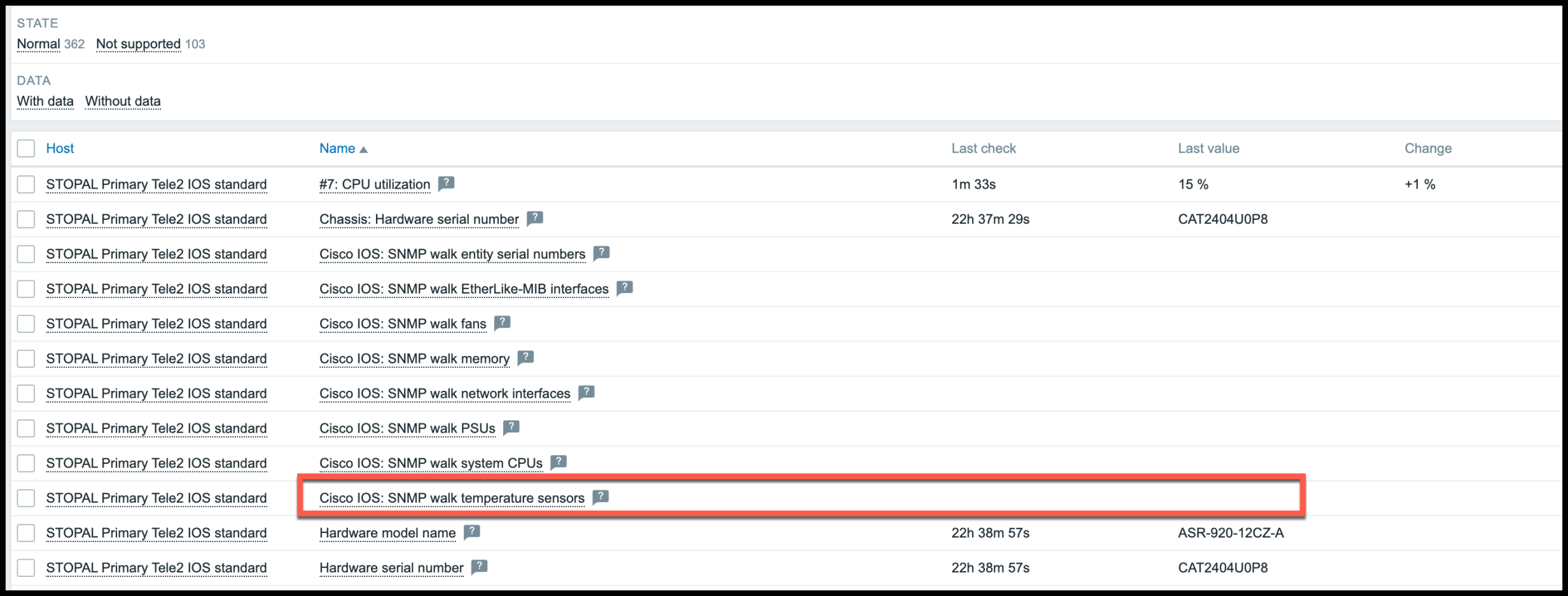

    I have tried quite a few of the existing templates for Zabbix, but so far no luck with getting temperature values.
    Here is as an example the "Cisco IOS by SNMP" output:

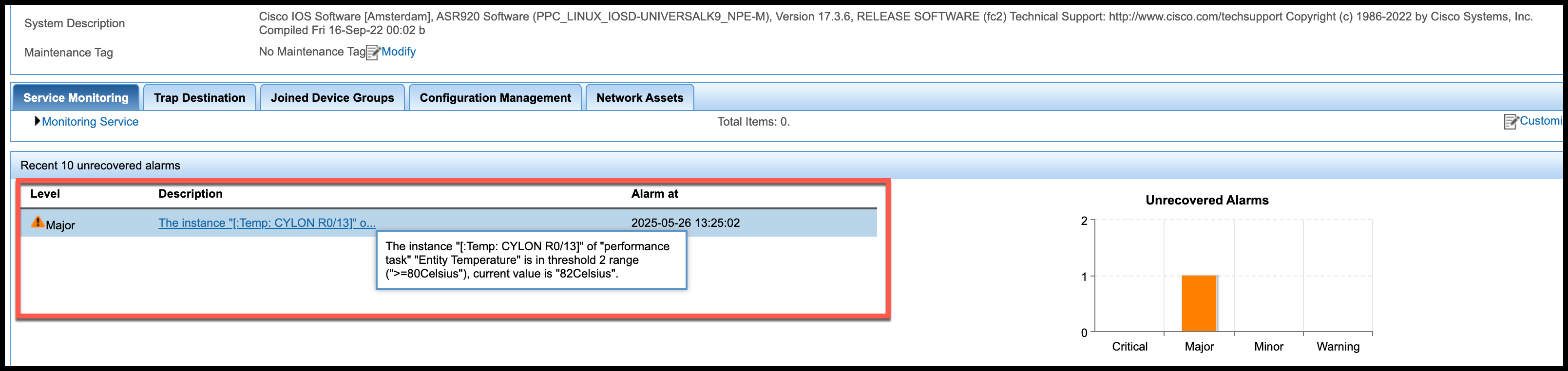

    I do know that it is possible to get the temperature readout, because I have added the routers to another monitoring tool that I am trying to decommission, HP iMC, it looks like this:

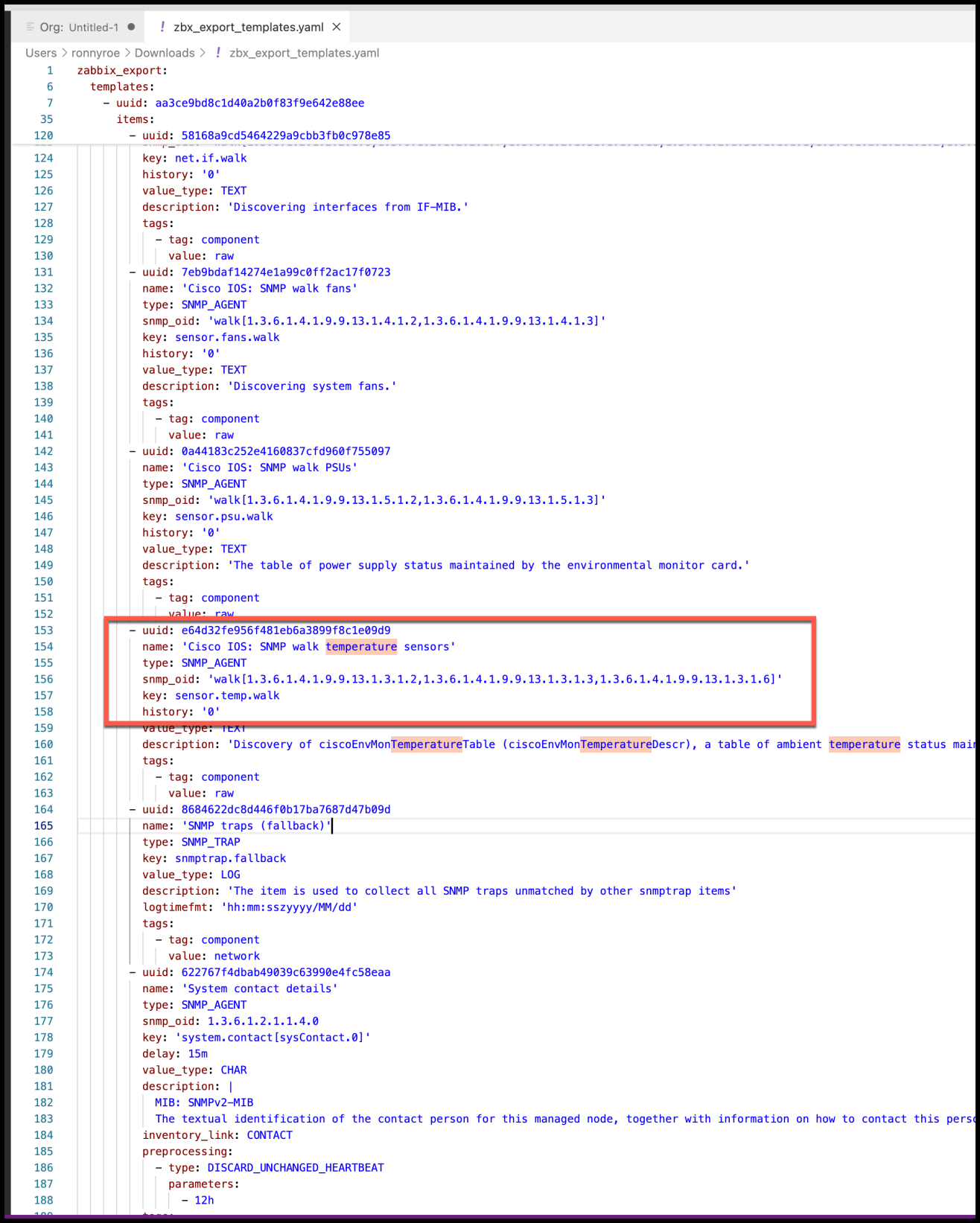

    I took the template "Cisco IOS by SNMP" and exported the YAML locally. I opened it in an editor and searched for the word "temperature". Found this:
    Should I just modify the OID value that I got from the AI query and rename the YAML to a new modified name and then import it into Zabbix again?
    Is this the right way to do this, or is there a better way?

    That thing in HP iMC might be a trap, not a polled value.
    and no, do not go and modify that template. AI just pointed you to general "tempertute status table", which is used in this template anyway... https://mibs.observium.org/mib/CISCO...ureStatusTable
    That walk there on your first pic (and in template pic), is using 3 entries from that same table...ciscoEnvMonTemperatureStatusDescr, ciscoEnvMonTemperatureStatusValue, ciscoEnvMonTemperatureState. That same walk is so called "master item" - its data is not saved, it is used for discovery and data extraction. If you do not have any temperature sensors discovered, then start with investigating, can you get data from command line (snmpget/-walk). You can also change that master item to save the data for some time, so you can see, if it manages to poll something.
