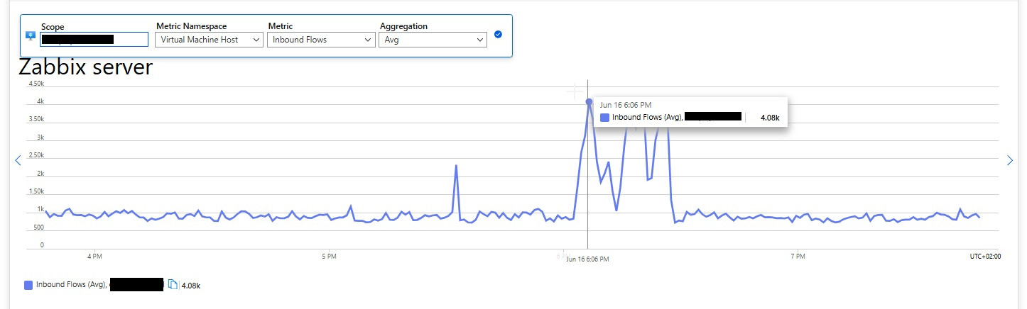

          If you look at the picture this is what we see when Recv-Q is pilling up, a sudden high inbound flow to the Zabbix server.

            BradKnowles I have just changed it temporarily :
            sudo sysctl -w net.netfilter.nf_conntrack_max=524288
            cat /proc/sys/net/netfilter/nf_conntrack_max
            524288
            • AspenKle
              • Feb 2024
              • 12
              BradKnowles
              We got the same result right now:
              Proto Recv-Q Send-Q Local Address Foreign Address State PID/Program name
              tcp 0 0 127.0.0.1:12563 0.0.0.0:* LISTEN -
              tcp 4097 4096 0.0.0.0:10051 0.0.0.0:* LISTEN -
              tcp 0 0 0.0.0.0:10050 0.0.0.0:* LISTEN -
              and did a restart sudo service zabbix-server restart, then the queue went down.
              Zabbix must be eating some data that takes way to long to process, but the funny thing is that we see no alerts over 75% for any zabbix util* (trapper*poller*histsync*unreach* etc process.
              The thing we do see is Utilization of trapper data collector process, in % goes to 0, when Recv-Q goes over 2k
              It is still:
              524288

                      Anyway Markku and BradKnowles, thanks for the information.
                      It turns out that this escalated after the number of hosts increased over the years.
                      Fix 1, made it better, we use passive but some agents had both configured, so we commented out :
                      Server=ZABBIX-IP
                      # ServerActive=ZABBIX-IP
                      When ServerActive is configured, it asks for new configuration after RefreshActiveChecks settings, this causes some tcp traffic on 10051, that we do not need, Recv-Q lower.
                      But this was not the root cause.
                      Fix 2, made it much better and seems like the root cause.
                      Some trapping agents (now 3 agents x 68 servers) uses https://www.nuget.org/packages/ZabbixSender.Async/1.2.0.
                      The
                      await sender.Send("MonitoredHost1", "trapper.item1", "12");
                      Was not handled correctly in the .Net agent, causing almost spam on tcp 10051, now it is handled correctly by dev, Recv-Q much lower.
                      Fix 3 or observation, the environment is scanned frequently using a Vulnerability Scanner, this also had in impact, that was the reason for this daily 01:00 problem.
                      Recv-Q is zero in general now.
