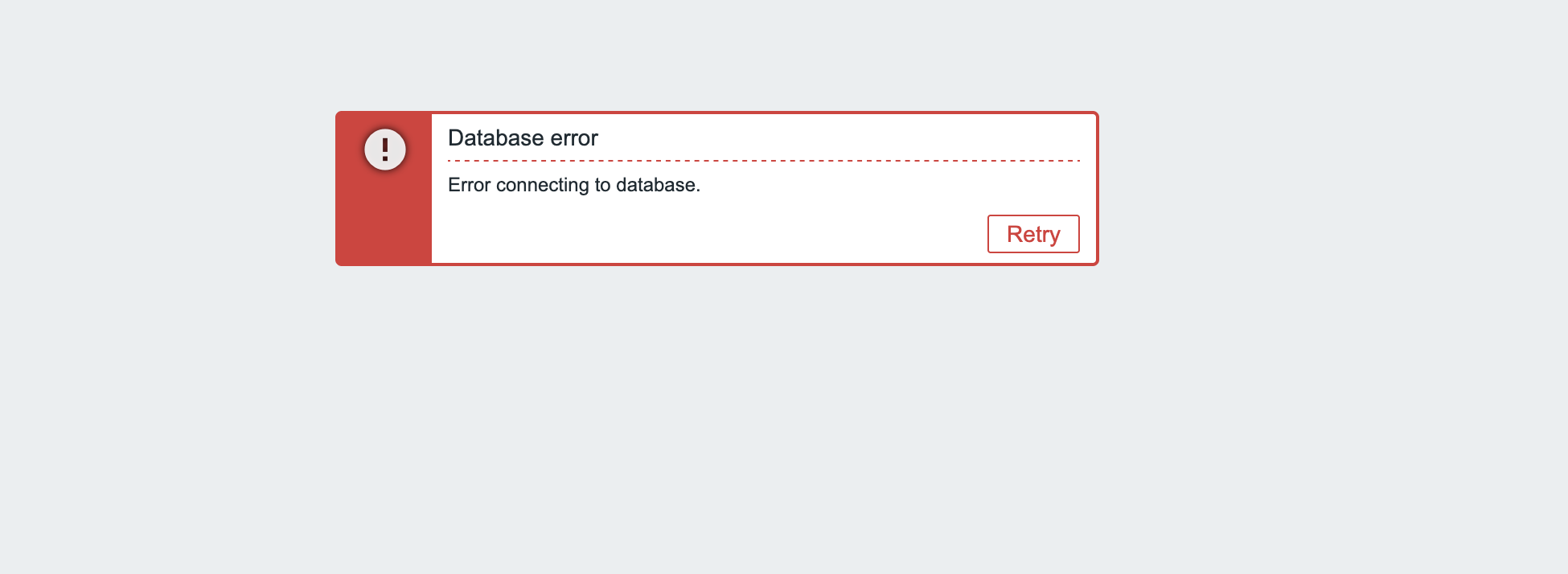

    After restarting the zabbix-server and zabbix-web containers, they are able to connect to the PostgreSQL database. However, when I try to access the Zabbix web portal, I encounter the following error: "Database Error: Error connecting to database." (Please refer to the attached screenshot.)
    I dont see any error in zabbix logs related to this issue, If anyone has experience using Azure SaaS database with Zabbix and has faced this issue, your help would be greatly appreciated.

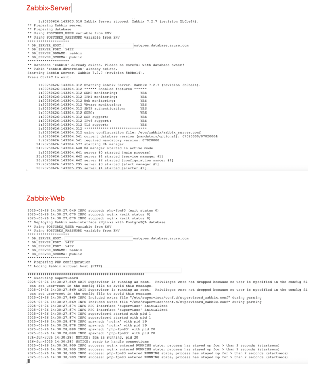

      Hi Markku When I restart the web container, the logs show that it is connecting to the database. However, when I try to access the Zabbix portal, it throws an error, and I don't see any logs in the container console when accessing the portal." see the attached logs screenshot.
      Note: I am using Azure Flexible Postgres Database.

        In your picture, the upper one ("Zabbix-Web") is Zabbix server, not web server. Lower one looks like a web server.
        I'm pretty sure the nginx+php container saves access logs somewhere, you just need to find out where. That's one of the problems in containers: it is not always clear where the newly created application data (like logs) is saved.

          you correct attachment is not correct, i updated the picture again.
          Everything works fine when I use the PostgreSQL database in a local VM container, and I’m able to access the Zabbix portal. But when I point the database to the Azure managed DB, it throws an error. It looks like an issue with SSL while connecting to the Azure DB, as the "require_secure_transport" setting is enabled by default.
