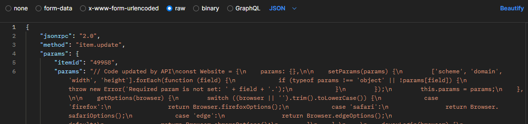

    Hello santosra02 not related to my problem but I did find a "hack-ish" workaround to update script in Browser item.
    Basically I stored script inside of a JavaScript variable as multi-line string then used function JSON.stringify() on that string variable, copy and paste output of JSON.stringify() into an API request under params and it worked.
    For example:
    let myBrowserScript = `// Code updated by API
    const Website = {
        params: {},
        setParams(params) {
            ['scheme', 'domain','width', 'height'].forEach(function (field) {
                if (typeof params !== 'object' || !params[field]) {
                    throw new Error('Required param is not set: ' + field + '.');
            this.params = params;
        }, ... // REMAINING PART OF THE CODE
    let myBrowserScriptJson = JSON.stringify(myBrowserScript);
    My API request looks something like:
    Not an elegant solution but it works and I am still learning Zabbix.
