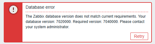

    Every time I update the Zabbix server, I get the same error: 'The main server is offline.' How can I solve this issue? As a result, I am forced to roll back the VM to its previous state.

    i have updated to version 7.4 but im getting this error

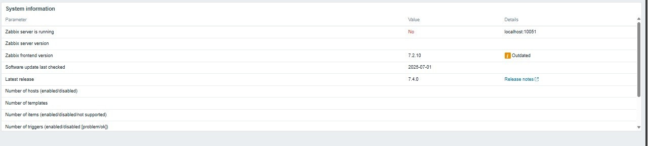

      Have you restarted zabbix-server service?
      What does zabbix_server.log say?

        Thank you very much. It seems that when you become accustomed to automating workflows with one-click management of multiple servers over a long period, you tend to overlook the basics. The system is now working perfectly.

          Try setting the following
          mysql-uroot -p
          mysql> set global log_bin_trust_function_creators = 1;
          mysql> quit;
          sudo systemctl stop zabbix-server
          sudo systemctl start zabbix-server
          Perform the upgrade again and set the log_bin_trust_function_creators back to 0 when you are done.
          See if that helps.
