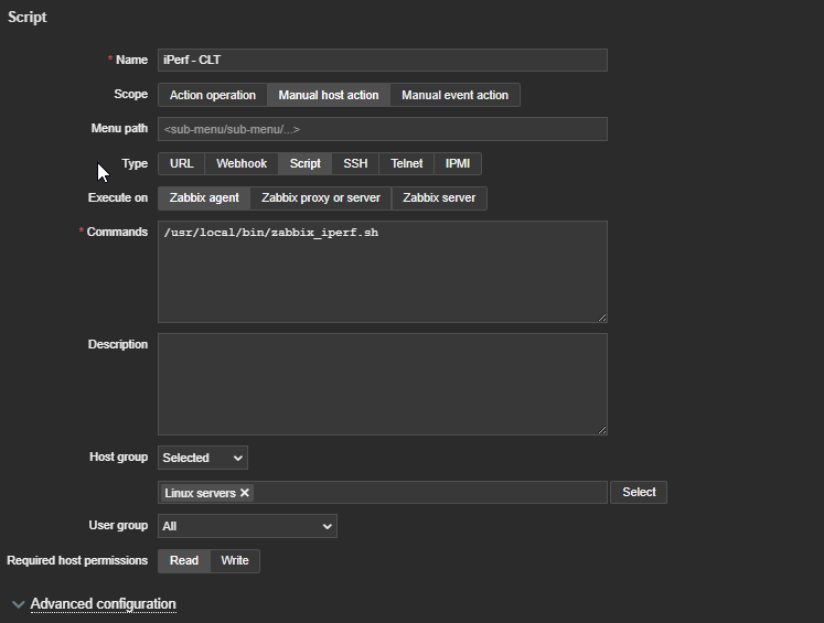

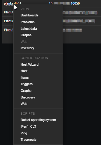

    I'm running zabbix 7.4 in a docker swarm deployment and I'm having issues running a custom script from the host selection in both the GUI/CLI of zabbix server.

    Running it from the GUI results in
    Running it on CLI from the proxy results in the same error
    root@zabbix_proxy_CLT:/var/lib/zabbix# zabbix_get -s <IP> -k system.run[/usr/local/bin/zabbix_iperf.sh]
    ZBX_NOTSUPPORTED: Unknown metric system.run​

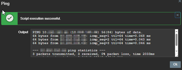

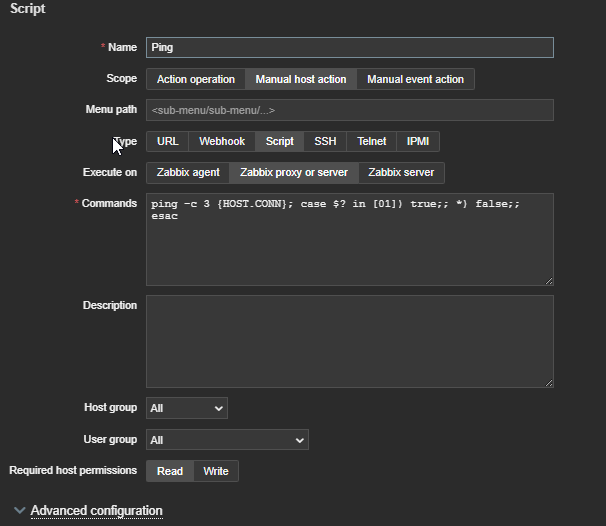

            So you have two scripts: "iPerf - CLT" and "Ping". Ping script works, and iPerf - CLT does not. If I understood this correctly, what is the difference between the script configurations?

              The ping script is a default zabbix script that's ran from the proxy/server

              Whereas the iPerf - CLT is a script ran on the agent's side
              Almost seems like there's some sort of disconnect between the Zabbix Server and Zabbix Agent. I get the same result outside of the docker setup where I see the following debug log from the server when running the script.
